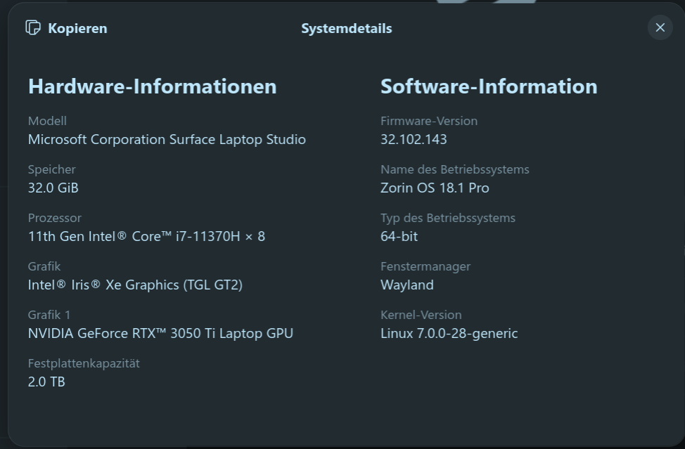

I’m relatively new to Linux and would like to take this opportunity to briefly introduce myself. I’m 62 years old and live in Switzerland. I don’t have much experience with Linux yet. However, a few small Raspberry Pi projects have sparked my interest in Linux, so I decided to give it a try. That’s why I installed Zorin OS on my main system (Microsoft Surface Laptop Studio, 1st gen.) at the end of February.
Using the instructions from this forum, I was able to successfully install the Linux Surface kernel, and most of the hardware worked as well. However, I haven’t been able to get the NVIDIA GPU to work on kernel 6.19.8-surface-3.
Since installing kernel 7.0.0-28, the NVIDIA GPU has suddenly been working perfectly, but the touchscreen has stopped working. However, I was able to find a solution. Even the Surface Slim Pen 2 works, and it appears that the pressure levels are being rendered correctly, as a quick test with Krita showed. I now have a fully functional system running kernel 7.0.0-28-generic.
I don't know if anything has been posted about this yet. I couldn't find anything using the search function. In any case, here are the steps for enabling the touchscreen (with a little help from Gemini). Maybe it'll be helpful to someone.
