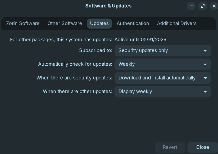

BUT for now I have set the updates to recieve Security Updates only.

And when You don't use unattended Update?
I see the option to download but not install... I want to get security updates only... please no new kernel for the time being.
I meant, when You use the Software Updater Tool and untick the Kernel Update Packages.
