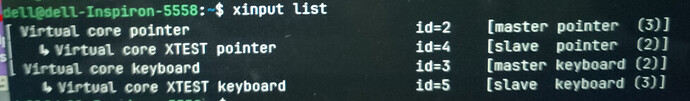

Wayland xinput list Output:

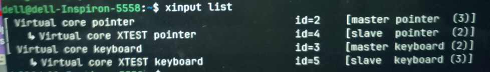

Xorg:

There seems a lot of reference to 'virtual' in your screenshots. Are you running Zorin as a VM (Virtual Machine)? Additionally, did you check the SHA256 checksum of the downloaded iso of Zorin before installing?
