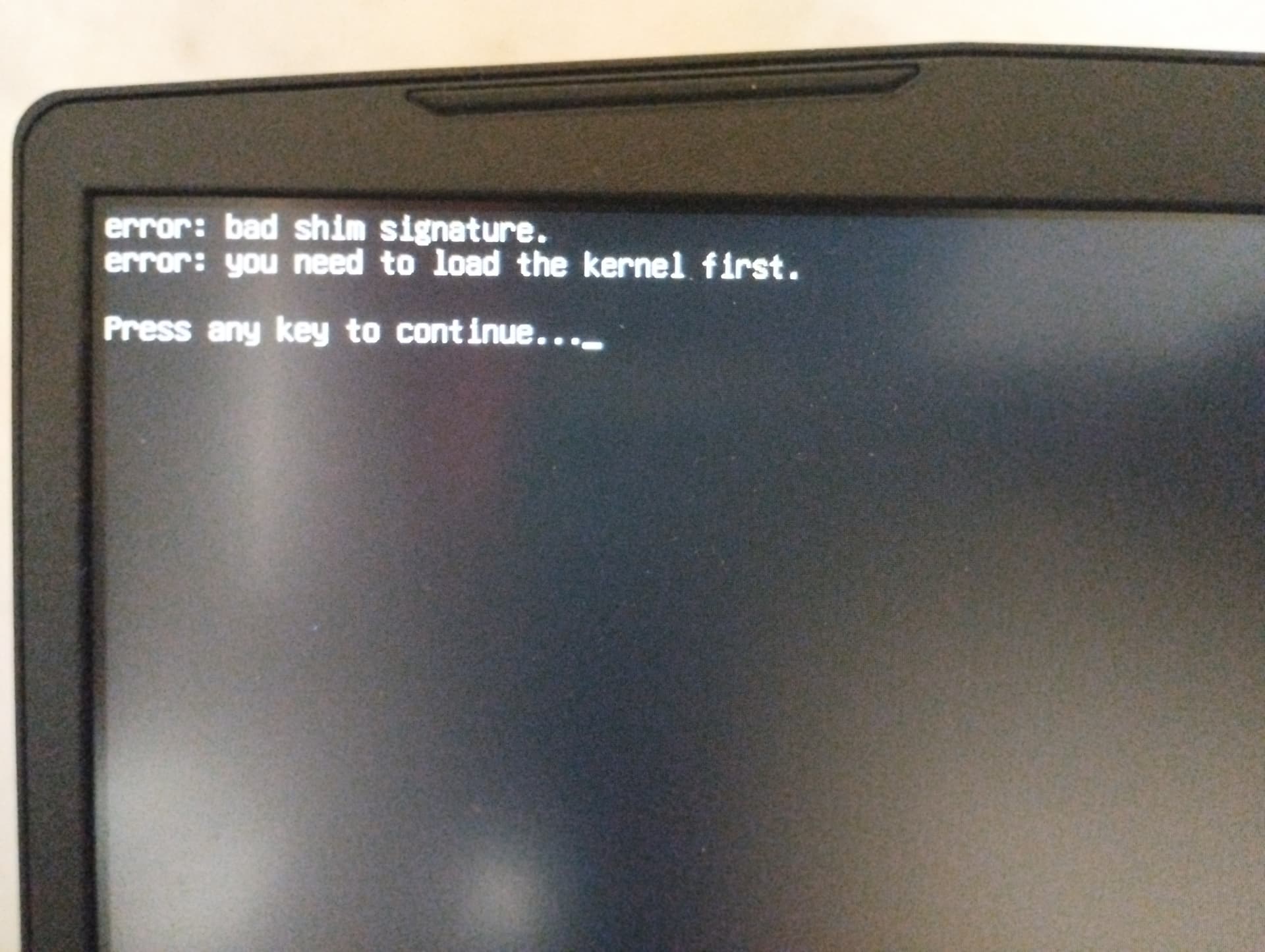

After upgrading kernel , it's showing this now .
If you are not dual-booting with Windows, you can disable Secure Boot in your BIOS EFI settings.
Then boot up normally.
If you are dual booting with Windows and you want Secure boot enabled, you can use the Grub Menu to access Advanced Options for Zorin and select the previous working kernel to boot from.

Is secure boot enabled or disabled?
Which kernel are you booted into?
Did you try installing xserver-xorg-input-all?
As per the instructions, i installed
xserver-xorg-input-all and restated the system and selected the previous working kernel version from the advanced version for zorin.
Is secure boot enabled?
Yes , secure boot enabled
Try it with disabled Secure Boot.
