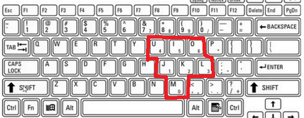

That sequence points to numeric keypad, that shares alphanumeric keys, being activated. e.g.:-
Is there a key or switch that enables the embedded num pad on the keyboard?
Many many thanks, this was the solution!
I have had this laptop for over 10 year and never once had this problem. Such a simple fix. And shift M was pasting what I had last copied.
Yes numlock was enabled! What an easy fix. Thank you! Never had this issue before.
