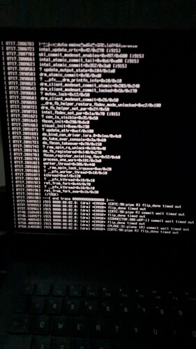

​Hi everyone,
​I'm running into an issue where my Linux laptop fails to power off correctly. This started happening recently, and I’m not sure what triggered it.
​Specs:
​CPU: Intel i7
​GPU: Nvidia
​Setup: External monitor connected via HDMI
​When I try to shut down, the process hangs and I get the following CRIT errors related to the display pipe:
[CRIT:...] pipe #) flip_done timed out
[CRIT:...] pipe #) commit wait timed out
[CRIT:CRTC:...:pipe-#] commit wait timed out
[CRIT:Displayplane:...] commit wait timed out
Has anyone encountered this "flip_done" timeout before? Any advice on whether this is a driver conflict or a specific kernel issue would be appreciated.
You might try switching to Xorg, as this is much more prevelant on Wayland.
Or, try adding the following grub parameter : i915.enable_fbc=0
Do Not Use nomodeset.
It will look like GRUB_CMDLINE_LINUX_DEFAULT="quiet splash i915.enable_fbc=0"
Tap ctrl+o to overwrite, then enter key to save as current configuration. Tap ctl+x to eXit the editor.
Now, you must run
sudo update-grub
and reboot to test.
  • If Windows is installed: Is Fast Start-Up in Windows disabled?
Is this straight HDMI to HDMI or is any Adapter or Hub used?
