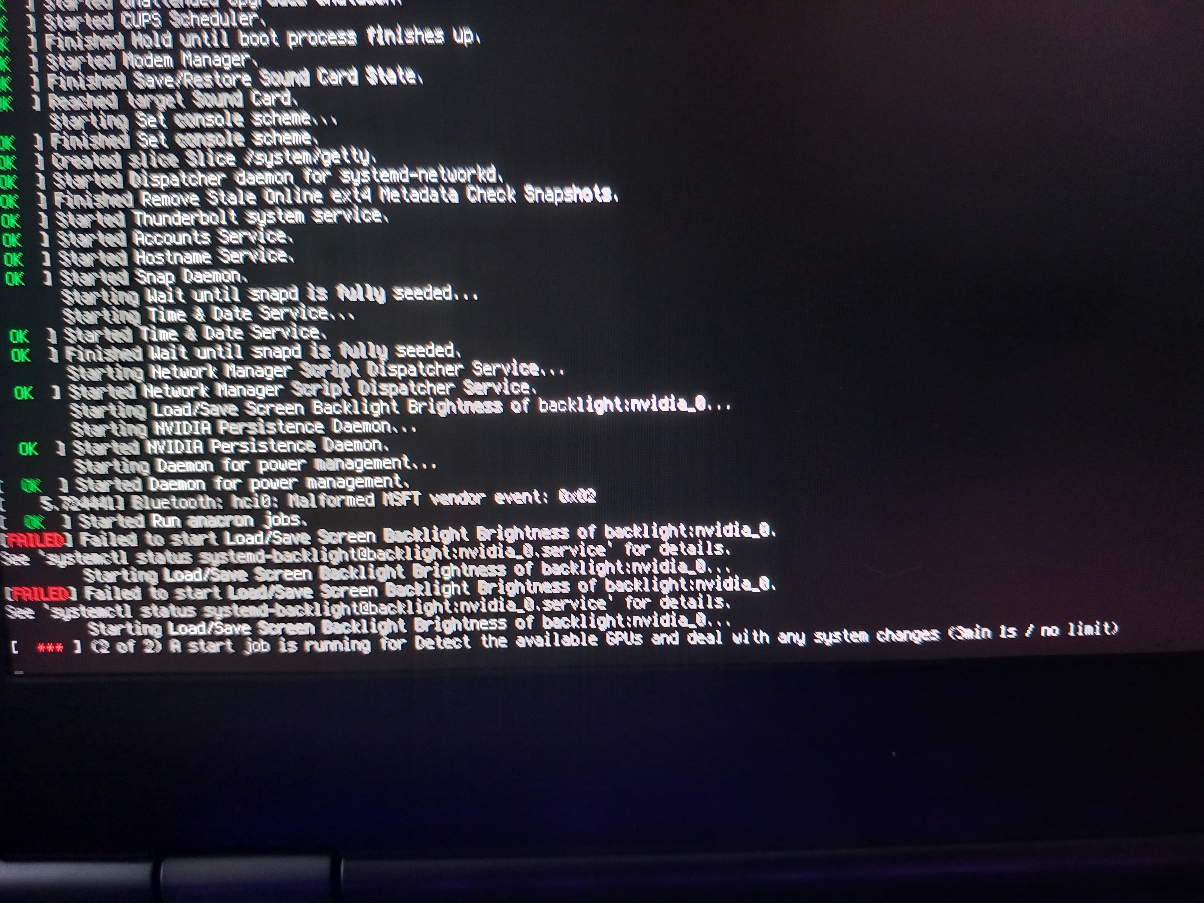

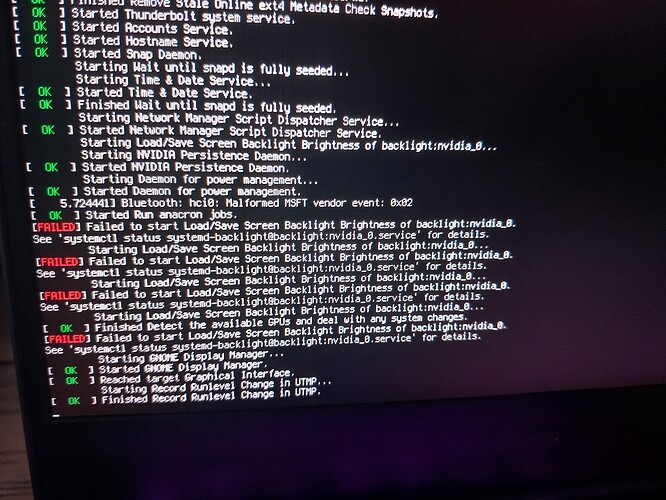

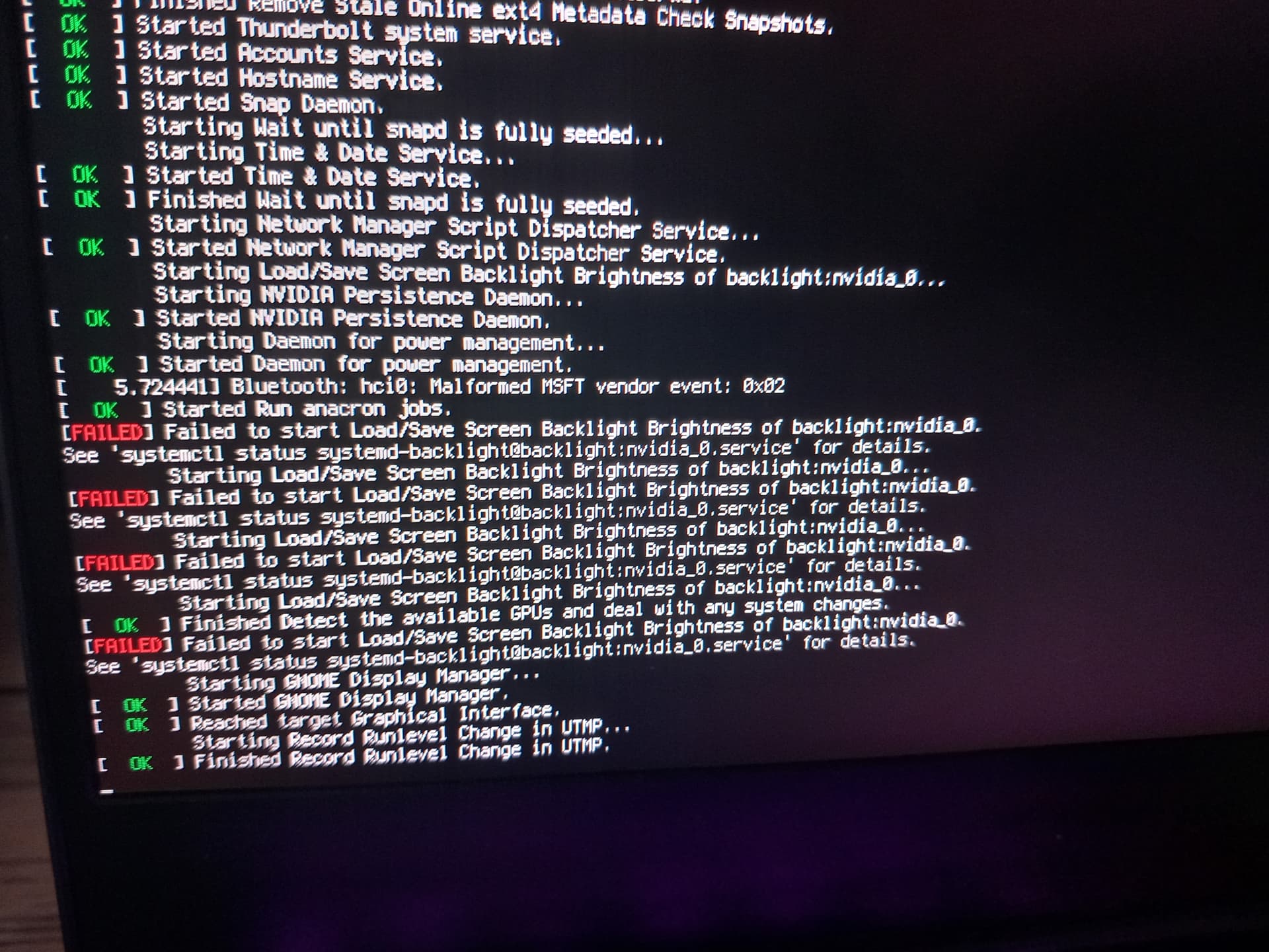

I have found a really strange bug. When AC is plugged in, then the laptop gets stuck. My laptop is a Lenovo Legion 7, with a NVidia gtx 2070 super. The BIOS is set for "dynamic graphics", and NOT "discrete graphics" as it causes an entirely blackscreen. The laptop boots fine without AC plugged in, and once Zorin has started I can plugin the AC without issues.
During the grub printout, it gets stuck related to the gfx. I will upload a screen shot if it helps, and people cant identify the issue from the description.
