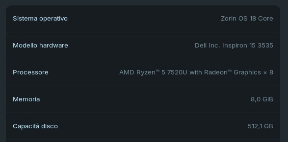

Hi. I mean, turning off the automatic standby helps waking up from manual standby. But still, I would like the automatic standby to be turned on. These are the specs. Thank you!
There's no solution that works for all devices. Suspend mode often makes problems in Linux. After a quick web search for your notebook I didn't found a solution. You probably need to spend a little bit more time to find a solution that works for you with automatic suspend by adding kernel parameters.
