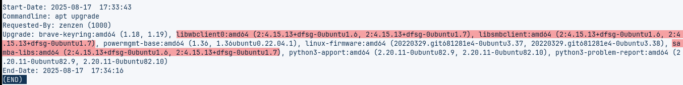

The log file in question is located at /var/log/apt/history.log. Towards the end of the file you will see the most recent entries. After running the upgrade I have the following:
It's not pretty, but you can read see which packages were upgraded, and the before/after versions.
libwbclient0:amd64 (2:4.15.13+dfsg-0ubuntu1.6, 2:4.15.13+dfsg-0ubuntu1.7)
libsmbclient:amd64 (2:4.15.13+dfsg-0ubuntu1.6, 2:4.15.13+dfsg-0ubuntu1.7)
samba-libs:amd64 (2:4.15.13+dfsg-0ubuntu1.6, 2:4.15.13+dfsg-0ubuntu1.7)

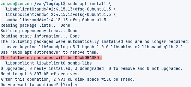

Unfortunately, you'll get an error saying this package was not found... well, let's see what's available:
apt show samba-libs -a | grep Version
It turns out that version "0ubuntu1.6" has been removed from the repositories altogether, but we can still try "0ubuntu1.5":
sudo apt install \
  libwbclient0:amd64=2:4.15.13+dfsg-0ubuntu1.5 \
  libsmbclient:amd64=2:4.15.13+dfsg-0ubuntu1.5 \
  samba-libs:amd64=2:4.15.13+dfsg-0ubuntu1.5
It worked:
You'll have to restart your computer most likely, but try that and see if it makes any difference before discussing anything else.

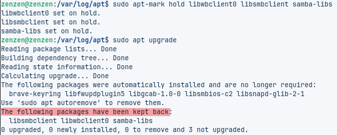

To prevent further updates on these packages you can mark them like so, with the command:
sudo apt-mark hold libwbclient0 libsmbclient samba-libs
Now, if you run sudo apt upgrade, this packages will show as being "held back". This is convenient but might also cause other issues in the long run, so it's best to rely on this only temporarily until it's clear what they change and how it can be fixed.
