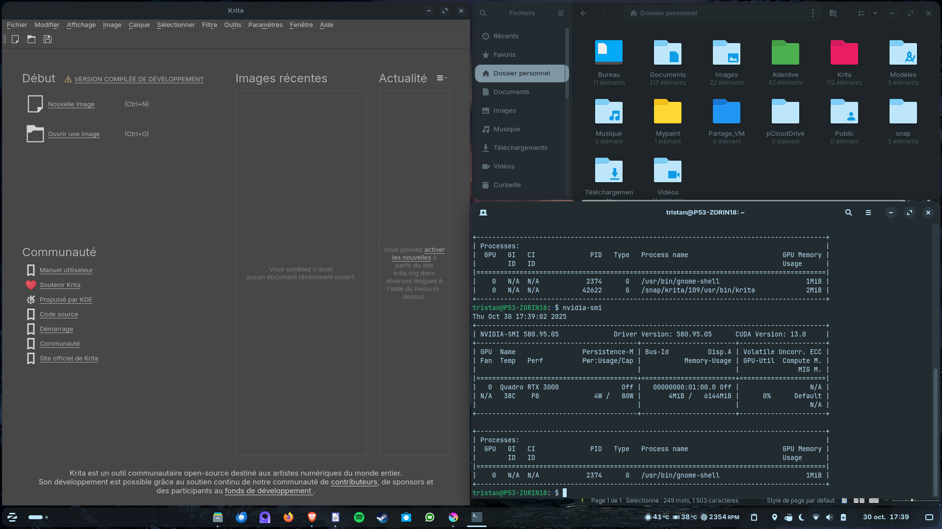

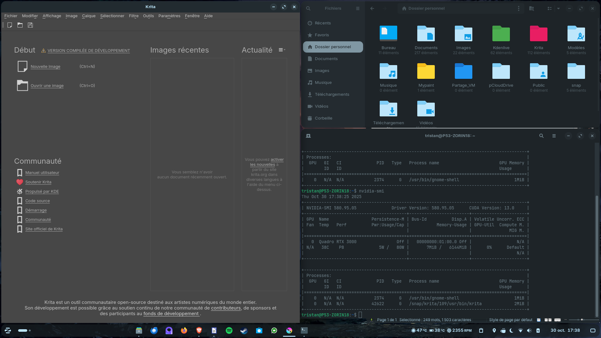

Hello,
With Zorin 18, if I try the command nvidia-smi to verify if Krita or Kdenlive for instance, are launched from dedicated GPU, I have any returns from the command line if these have been installed with Flatpak ; but it seems to work if they were installed from Snap
`sudo snap install (my_package)
I tried this with the Nvidia On-demand mode.
I also tried to launch them from Zorin Menu, Zorin Taskbar, Shell by choosing “run with dedicated GPU” (something similar, I have french version of Zorin 18).
I cannot remember if this occurred on Ubuntu / Kubuntu, since I’m use to install snap packages with the “Ubuntu’s family”, so this is not a “real problem”, just kind of feedback …
I first tried just after installed Zorin (yesterday), to ensure Krita’s Flatpak was using my Nvidia GPU when needed ; the funny things is that it was working as expected. I don’t know why today it doesn’t. The thing i did as usual with Ubuntu / Kubuntu), is switching to my Intel card when I needed and back to Nvidia or On-demand Mode.
It's funny that Zorin promotes Flatpaks—by giving us the choice with everything configured, which is pretty cool—but that Snaps seem to handle this type of hybrid GPU situation better... But this is perhaps my misunderstanding of these principles. :thinking:
