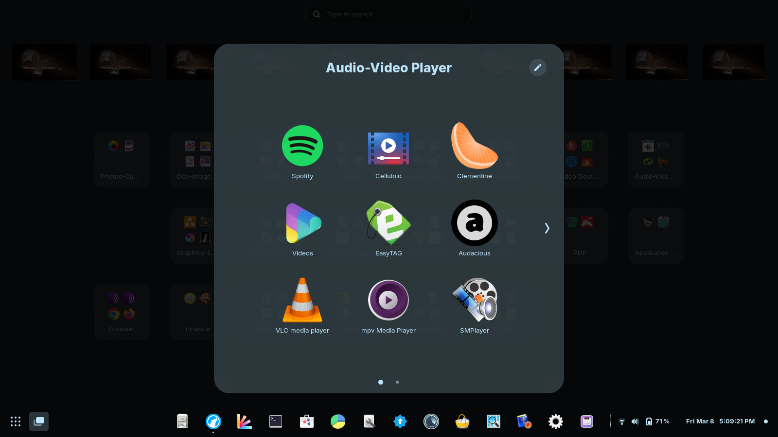

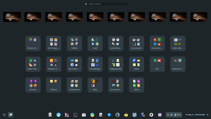

1/ Launchpad application sub-folders - i am using layout which has launchpad application at left bottom corner. To avoid scrolling back n forth, i made few sub-folders for each icon/app according to my requirements.
My issue is - while moving from one sub-folder to another, i have to press "Esc" each time, instead of clicking the mouse to make the sub-folder disappear and move to another... for reference, you can picture macos launcher...

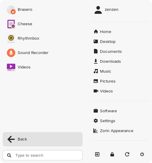

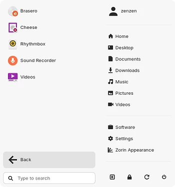

It would be helpful if you could take a screenshot of your desktop to better understand the first issue. As far as I can tell, at least with the default layout (there are three that have the launchpad at the bottom left), there's a Back button for that purpose:

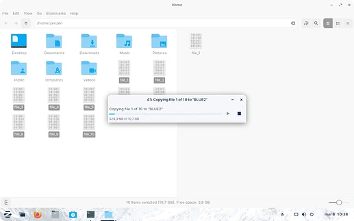

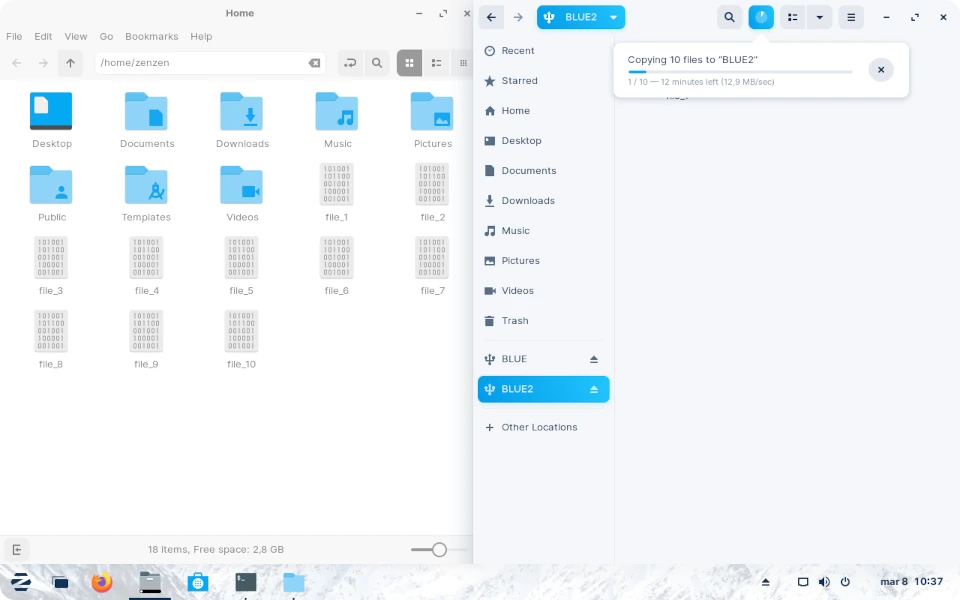

Regarding the third issue, I'm seeing a progress indicator normally on both Nautilus and Nemo while transferring 10 files of 1Gb each:
I tried this on ZorinOS 16.3 Core, which version of ZorinOS are you using?
1/ Layout used - image
Screenshot from 2024-03-08 16-58-31
2/ Launchpad application - image
3/ Launchpad application subfolders - image

I need to apologize on pt 3)...launchpad application subfolders
I just realized that the mouse click is working to make the subfolder disappear.
the mouse click works on certain areas only... and i was clicking on the bottom side which was not working....
see video link as reference- https://imgur.com/a/dupEndK
Although, it would be great - if the mouse click would work in all areas/screen..

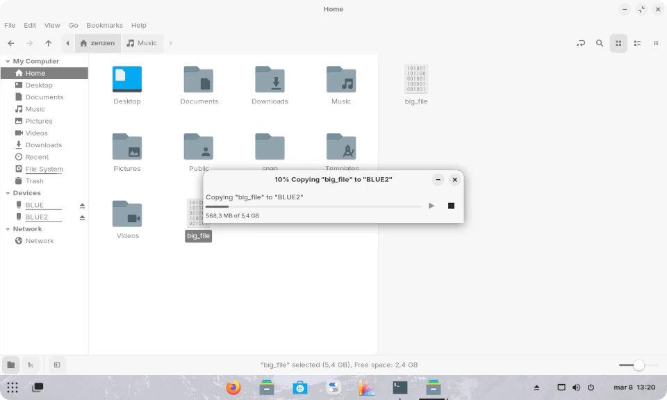

I can't be sure but I'm guessing that the progress indicator only appears if it takes more than some predetermined amount of time. I've noticed in the video that the transfer happens relatively fast on your machine, compared to how long it takes for my slow USB drive on a virtual machine:
This is on ZorinOS 17.1 Core, on a 5GB file. Are you able to test on a much larger file, just to increase the amount of time it takes and see if the indicator appears then?

EDIT: I appears that there is a 2 second timeout before the window appears. So if the operation takes longer than that, you should be able to see it.

I've noticed something:
When copying a file to an external drive, I get the progress bar window prompt. The other way around, however, it only shows me a notification exactly as it did for you in the first recording.
Interestingly, when I do the same operations within Nemo, using both panes side by side, I always get the progress bar.
I repeated this test also on ZorinOS 16.3 Core and had the same behavior. For completeness I did the same with Mint 21.2 too, where it worked flawlessly there as expected. Although this is not too surprising since Nemo is developed by Linux Mint for their in-house desktop environment, Cinnamon.
My guess is that there's something in how it works that isn't fully compatible with the Gnome desktop environment in this regard.
You can simply click outside of the folder to exit it :thinking:

yes, i realized this later and i am getting around it....but if zorin is providing macos or ubuntu types layout, then it should be able to function in the exact way as it is supposed to be..i.e full screen.....if clicked on any area/spot of the screen, the folder should exit (not particular areas).. - this should also be applicable for Launchpad...presently the launchpad does not exit when clicked on any area of the screen.... inorder to exit launchpad (not launchpad folders) i have to press "Esc"...

Nemo does work on Gnome even if there are a few rough edges. The issue with progress indicator when copying files can be easily worked around by using the very feature you are requesting to be implemented in Nautilus: instead of copying the files directly on the desktop, do so on the other pane within Nemo.
I'm not sure about the folder issue but there's definitely something going on there. Most the time it works fine for me regardless of where I click (as long as it outside the folder) but there have been a few times where I have to insist a bit.
