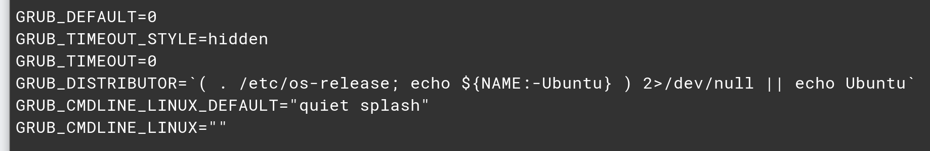

You could try it with adding a GRUB Value:
Open the Terminal and type sudo nano /etc/default/grub and in the opening Overview look for the white Textblock:
On the Line GRUB_CMDLINE_LINUX_DEFAULT You add this: snd_hda_intel.dmic_detect=0
So, the Line should look like this:
GRUB_CMDLINE_LINUX_DEFAULT="quiet splash snd_hda_intel.dmic_detect=0"
Then press ctrl+o to save the change, Enter to confirm and ctrl+x to exit. Back in the normal Terminal Overview, type sudo update-grub to make the Changes affect. Don't forget that! Without it, it will not work.
