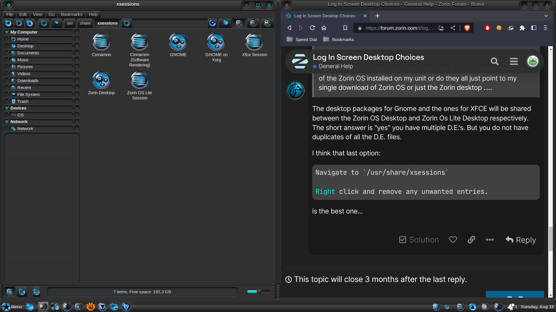

Here is what shows up in my Nemo "xsessions folder" .....
If I remember correctly the Xfce is for Xfce to operate on Zorin OS 6.3 Pro and not lite .... but I needed the lite anyway ....
Looks like I'll just have to ignore the extra choices as they don't show up in the Nemo folder ..... no big deal ..... thanks for your help ..... marked as solved .... :+1: :smile:
They do...
The Extra Gnome is there. Gnome on Xorg is there. XFCE Session and Zorin OS Lite Session are both listed in there.
