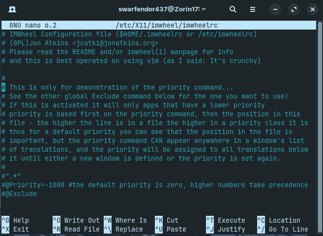

Open a Terminal and enter:
sudo nano /etc/X11/imwheel/imwheelrc
edit the line after ".*" that is to say hit return to enter a new line and don't include # - this is the equivalent of REM in DOS which means it is a 'remark' not a command to be executed.
hmm this is wierd that folder is empty the imwheelrc isnt there ill try removing and reinstalling im wheel

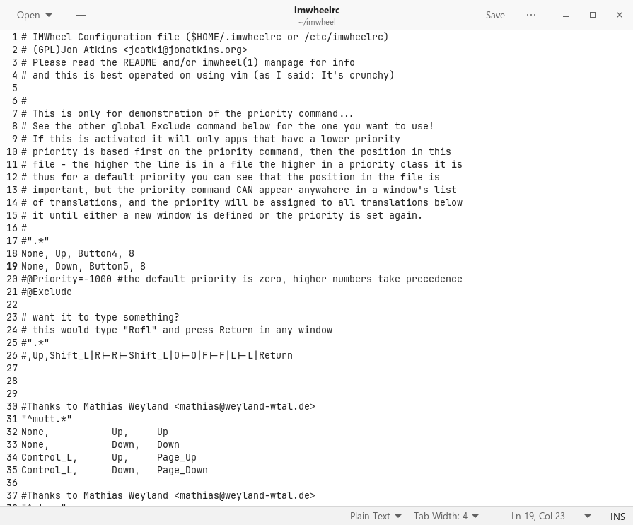

like this?...does nothing even after a restrat
this is where i got it working but speed is fast i am using X11 not wayland
