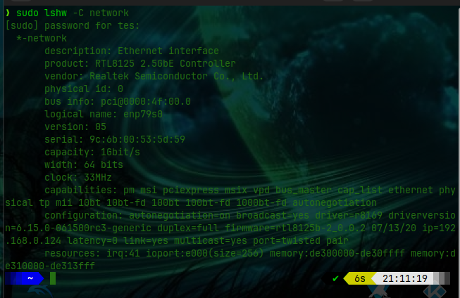

To start, can we identify your device?
sudo lshw -C network

Have you tried
sudo modprobe -r r8169
sudo modprobe r8169
If that still does not work, we may need to reinstall the driver.
sudo apt remove r8168-dkms
sudo apt install r8168-dkms
Thanks for the help. After much frustration and cussing at the computer, I finally figured it out. Kernel 6.14.3 breaks networking and BT on my system. 6.14.2 is completely fine, as are all the prior ones down to 6.11. (anything lower and my wifi won't work as there is no driver for it in older kernels). That's why I couldn't figure it out. It had been several days before I noticed that it wasn't working, so, mentally, I just wasn't able to make the connection lol.
