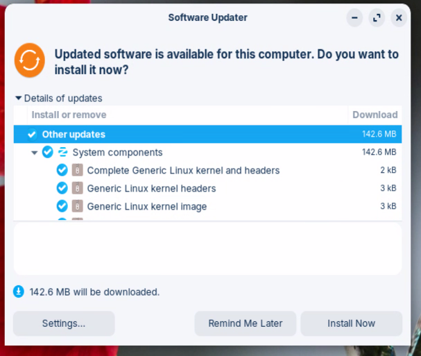

Also curious why apt shows several updates available but there's nothing in the Zorin software updater - but I'm thinking that may be related to all the ppa errors.

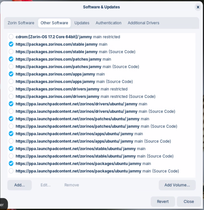

The "odd" looking one of course is the "zorin-os-ubuntu-packages-jammy", which you do not have. That is also the one that contains deb https://ppa.launchpadcontent.net/zorinos/packages/ubuntu jammy main, which is the one showing the 403 error.
I would just remove it, but that would leave me with no "packages" repo - don't know if that's OK or not. I guess it must be OK since it can't get to it now and it doesn't seem to be hurting anything other than my OCD. Also you don't have a packages repo.

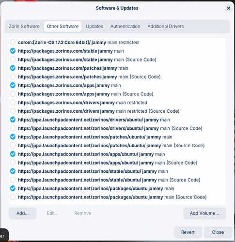

I really wonder if the zorin-os-ubuntu-packages-jammy repos are old, discontinued ones. If you look at the full list in the GUI in my install there looks to be a replacement in packages.zorinos.com/
No, not added manually.
I did tag the ZorinGroup to review this, due to this being a specific Repository question.
They are currently in active development on Zorin OS 18 and it may take some days for them to join this discussion.
In the meantime, are these errors preventing your ability to install software?

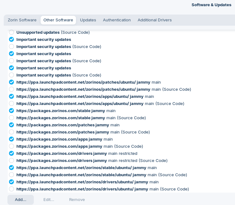

They are/were preventing Zorin updates from showing up in the GUI software updater, although the updates showed up in apt in terminal. It appears that the GUI software updater does not show updates if there are errors in apt update.
I tried unselecting the offending repo in software updater GUI and then it refreshed and showed the updates - apt update also runs clean now.
It must be an old repo. Probably worth someone looking at though, as you've suggested, since who knows how many other installs out there are having zorin updates held back because of these errors. There's NO indication to the casual user of any issues. They would have to do an apt update to notice it.
Current state after unchecking the offending repo:
