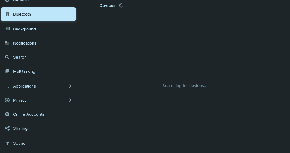

dont work
the terminal see new devices but in bluetooth settings nothing

Does blueman app reflect the same?
Install with sudo apt install blueman if needed.
After this ? The program has been installed
Launch blueman and under Adapter run search
Nope
