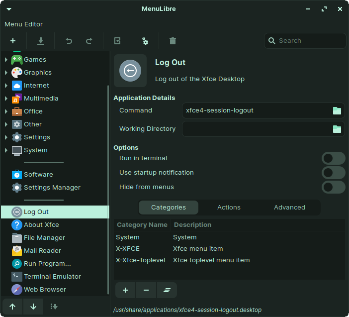

This is the actual settings from the zorin menu editor:

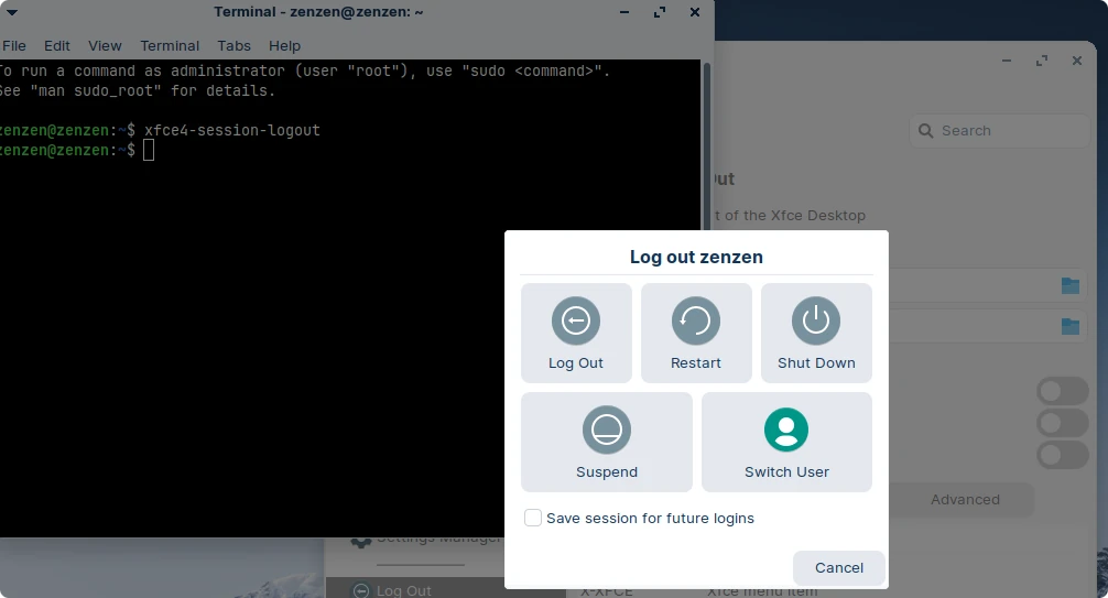

As far as I'm aware, the xfce4-session-logout command shows a prompt with multiple options to log out, power off, etc. Do you not see this? This is also the same behavior I have when I click on the "Shut Down" button from the menu.
I tried it and no when the command is given to the shell terminal the screen goes black for a second and I'm logged out to the login screen.
Since the command is the same for the button the behavior is the same when I click it in the main menu.

Have you tried
sudo apt install --reinstall xfce4-zorinmenulite-plugin zorin-os-lite-desktop
Screenshot_2024-01-18_11-33-30
Sadly it did not fix the problem, still the button behaves like before.
