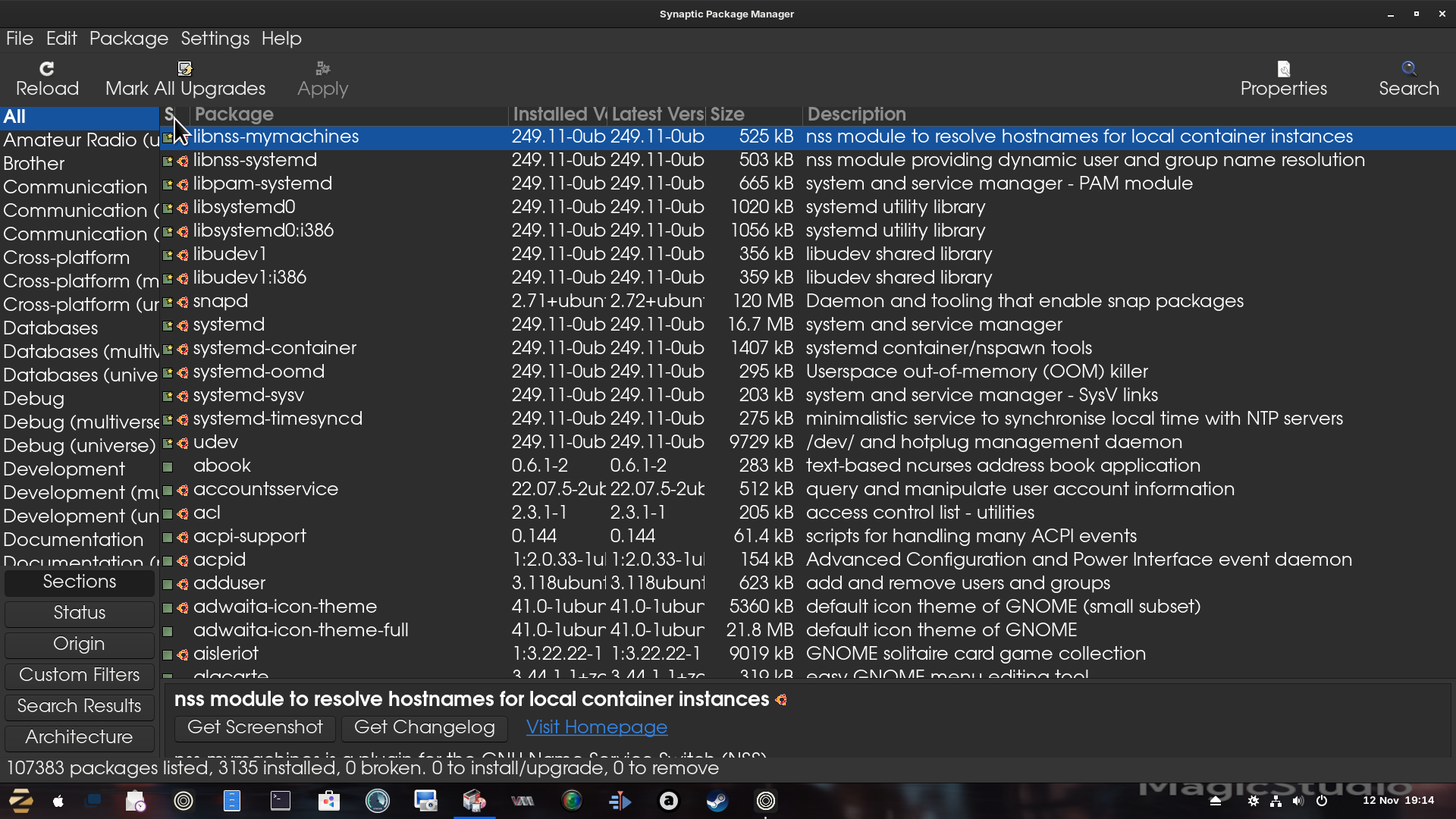

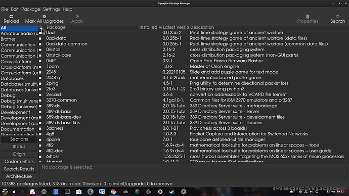

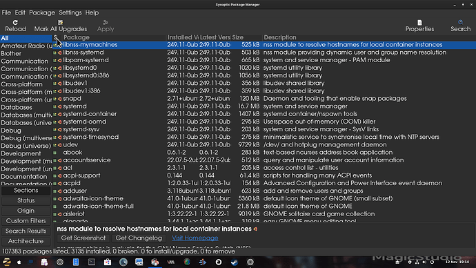

One other way to check what you have installed, if not already present, is to install Synaptic Package Manager. Once installed, Launch it then click on the column headed 's' - click on this and all your installed software moves to the top of the screen.
Before:
After:
