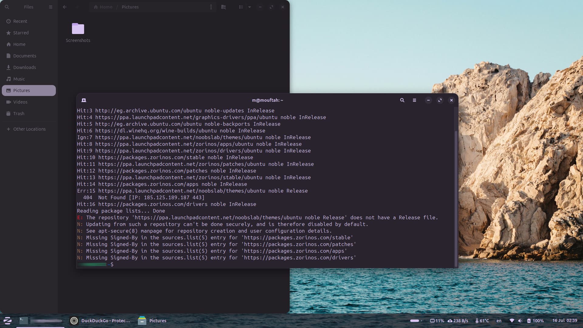

I ran sudo apt update and I got the following:
E: The repository 'https://ppa.launchpadcontent.net/noobslab/themes/ubuntu noble Release' does not have a Release file.
N: Updating from such a repository can't be done securely, and is therefore disabled by default.
N: See apt-secure(8) manpage for repository creation and user configuration details.
N: Missing Signed-By in the sources.list(5) entry for 'https://packages.zorinos.com/stable'
N: Missing Signed-By in the sources.list(5) entry for 'https://packages.zorinos.com/patches'
N: Missing Signed-By in the sources.list(5) entry for 'https://packages.zorinos.com/apps'
N: Missing Signed-By in the sources.list(5) entry for 'https://packages.zorinos.com/drivers'

However for sudo apt update I still get the following:
