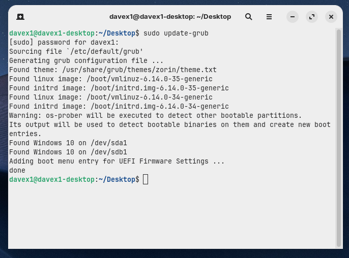

Now I have a need to run sudo update-grub (because I want to implement
a menu item I added to /etc/grub.d/40_custom).
Unfortunately I'm anticipating problems because the update-grub mentioned something about uefi (see image). Isn't Grub smart enough to know I'm on an
MBR system? Is there something I can do so that update-grub works properly?
Thanks for any info ...
EDIT despite my worry, the Grub menu behaved properly after rebooting the system, and my menu item appeared and is working.
Still, it's a little disconcerting that these references to uefi/EFE, etc. show up

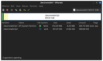

For clarification of your situation, to better provide you support, please provide us with your G-Parted on the drive. Here's mine for clarification of what I am talking about. Thank you!

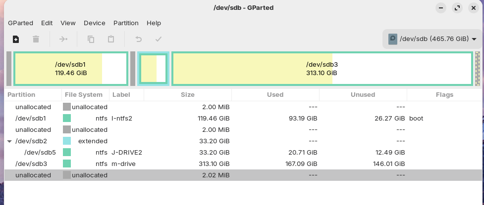

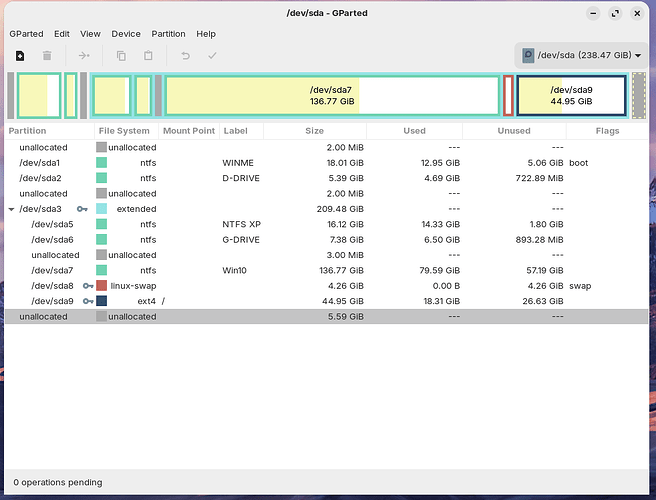

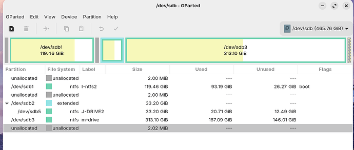

Hi thanks for your response.
Zorin is installed in sda9 (SSD) and grub is installed in sdb (HDD)

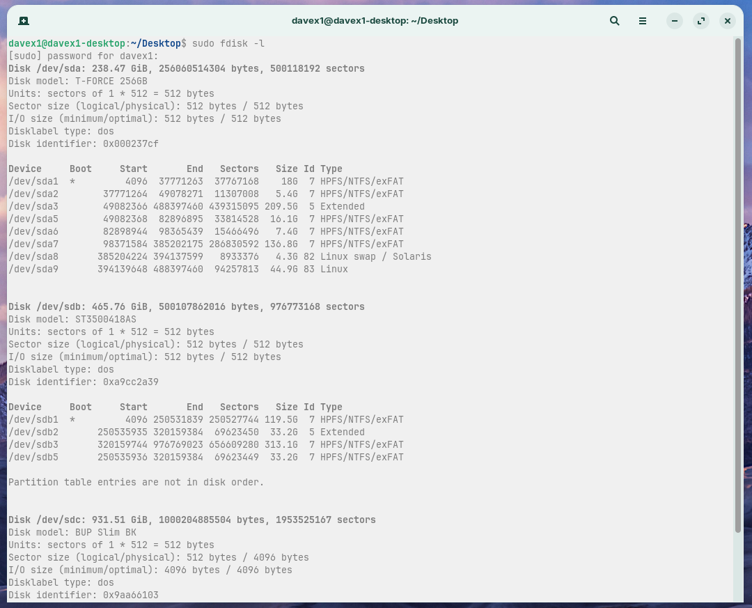

Here's fdisk -l for good measure
