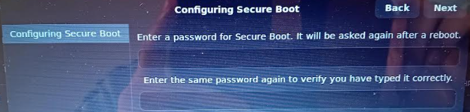

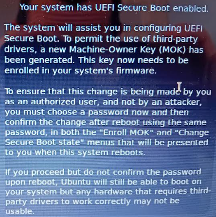

Following a previous question on the forum, I need some help concerning a new problem I am facing with Zorin 17.2 updates. I am a beginner. Today, I had an update including new linux kernels. My secure boot is enabled and I am using a dual boot configuration (Zorin 17.2 / Ubuntu 24.04).
During the update process, I had the following screens:
Then a second screen:
I indicated a password and confirmed it. I waited a few minutes. Nothing happened. I rebooted and the following screen appeared:

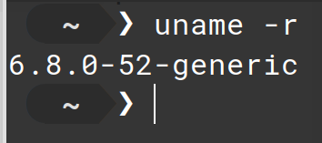

Because of the Kernel Thing: could You type in the Terminal uname -r please? It shows Your current Kernel Version. And then post it here.
4
Thanks for you help.
That looks right. I have the same:
