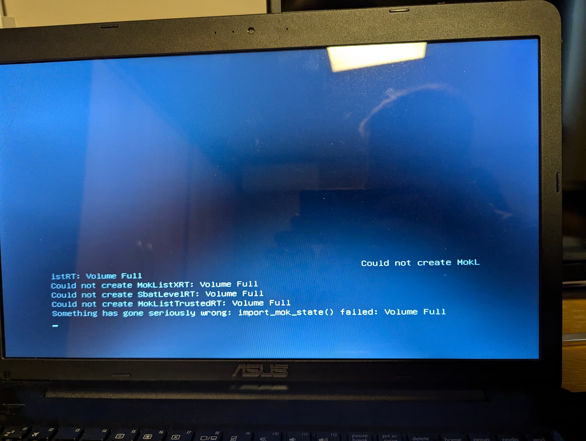

Hello guys,
I'm having a problem installing zorin os 18 core.
It keeps giving me the following error.
I've tried running it with secure boot on and off already this does not make a difference.
I've also tried csm on and off this does also not make a difference.

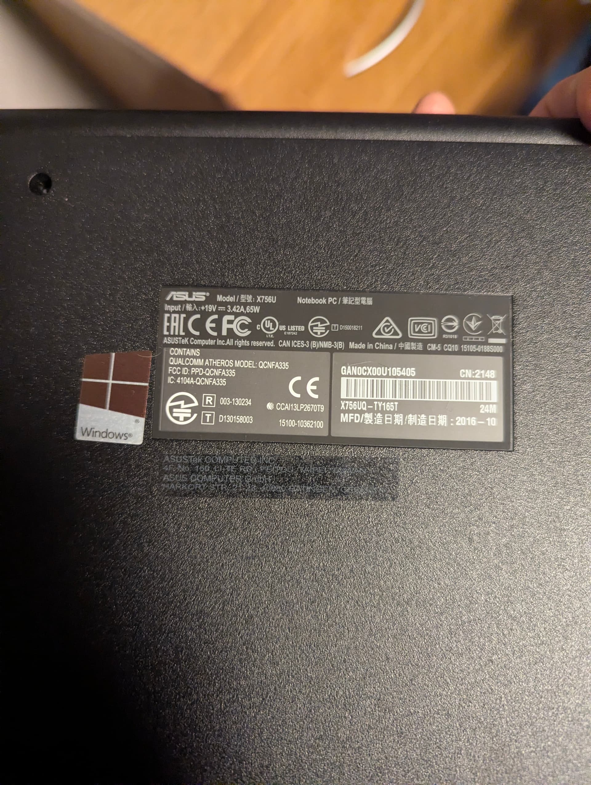

Information on the laptop that is being used.

Are You able to get in BIOS? If yes, disable Secure Boot and delete the Secure Boot Keys.
Thank you for the response.
I did try and turn secure boot off.
But I've never heard from secure boot keys.
I will check it out tomorrow and see if I can delete them.
It is not clearly labeled in the EFI settings.
Enable secure boot, then select to "Reset to Setup Mode" or similar...
Once done, disable Secure Boot and test installing.
Yeah, this is a bit a Matter of the Name like @Aravisian already mentioned. It should be near the Secure Boot Option itself.
Hey guys!
Deleting the keys worked!
