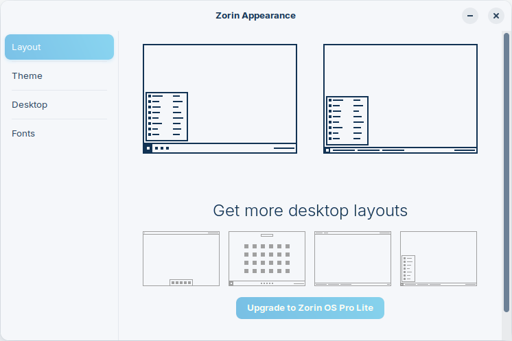

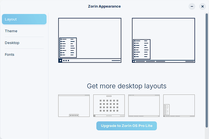

That looks oddly empty.... I'm not using Lite so I can't verify if that's how it's supposed to look like, but otherwise I would say it's possible some settings can't be applied to XFCE? Different technologies have different capabilities I guess.
Reinstalling "zorin-appearance" doesn't change anything. I've also re-installed Z.Lite and still same (didn't reinstall for this reason, of course!).
