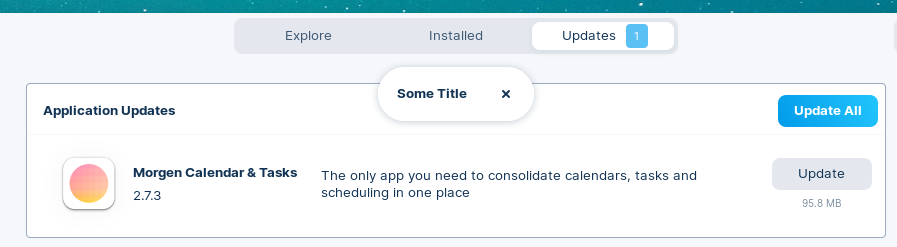

Thank you so much for persisting with this. I've followed your instructions, and now the error message is different. Best to see the screenshot:
This is obviously a default text string left behind by a programmer. Looks a bit amateurish, to be honest.
However, rebooting again and it all works. Thank you! I don't really understand why, though.

Some Title, really funny :rofl:. Now let's imagine this randomness applied to almost any warning :thinking:, let's see an example…
Some Title failed on doing something, PID some numbers, reason: something
:rofl:
