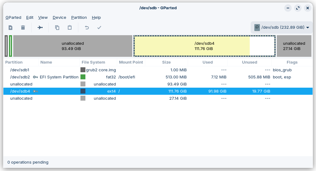

I've uploaded a screenshot from GParted.
The partition I need to move is /dev/sdb4 - in yellow.
I want to move it to the left next to /dev/sdb2.

According to your screenshot, your partition 2 contains your boot info. You can see this from the "Flags" portion beside the entires. I'm not sure if your system even needs the bios_grub partition anymore, but given it's so small, it's not a big deal to leave it.
What was most likely occurring was Gparted giving you a warning as since you're moving the partition that has your data on it, it may cause the system to not boot properly. Since all you'll be doing is moving the partition to the left, then increasing size to take up all the space to the right, I don't believe this should be an issue, but as always; Backup your critical data before doing any partition fiddling.
