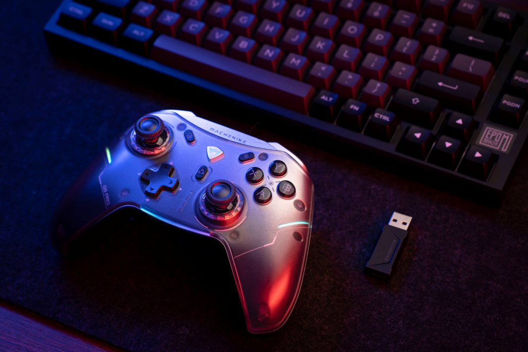

I have been using a Machenike G5 Pro on Linux for quite a while now. It's a multi-mode joystick that acts like a Switch Pro, an Xbox Controller or a D-Pad Controller. Wired, 2.4g or via Bluetooth.
It has gyroscope that are only exposed in Switch Mode.
This controller works out of the box on Linux, but it falls into DPad mode instantly. Which is playable, but missing features.

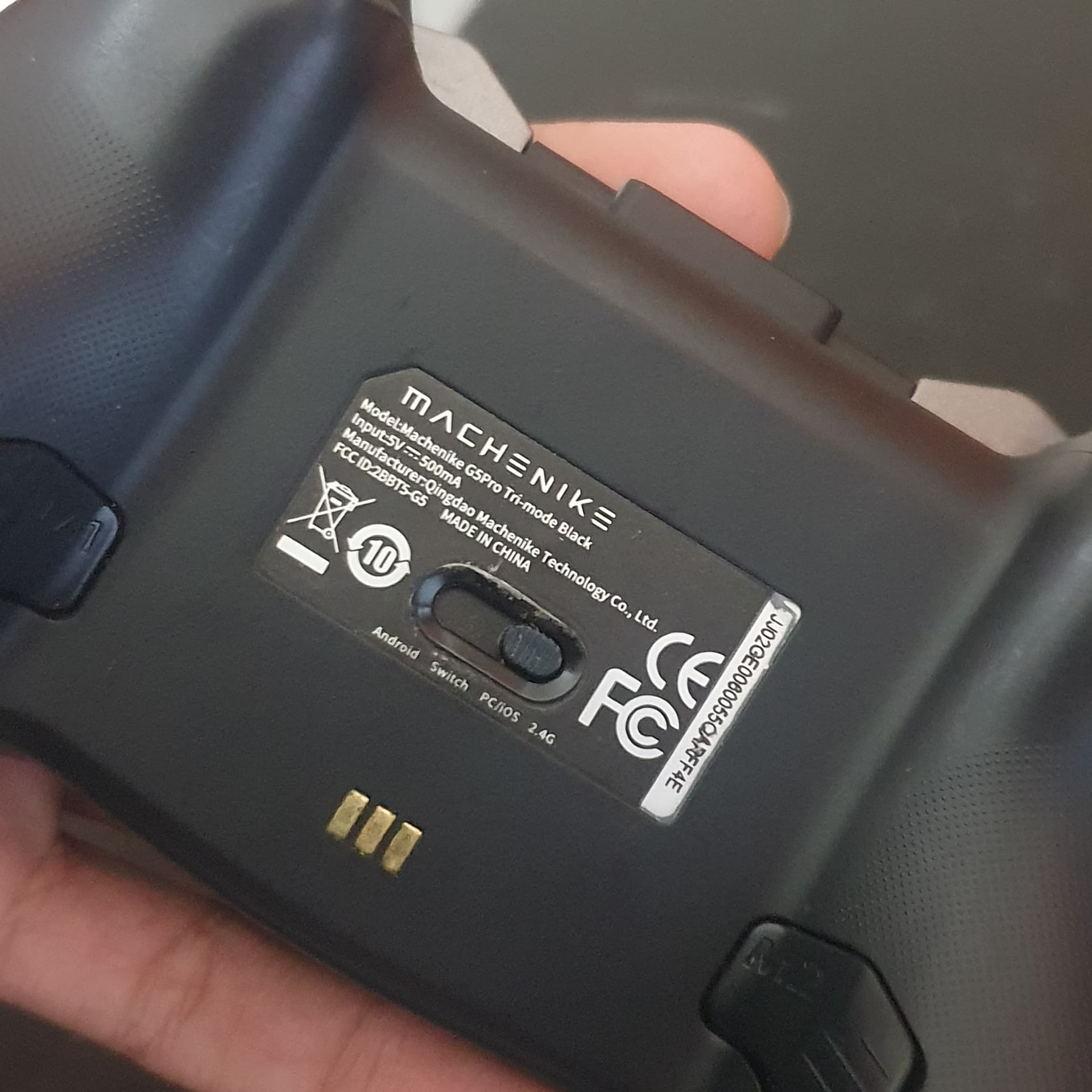

Via Bluetooth, that was kinda easier. The controller has a switch on its back, so the auto mode selection is bypassed.
  • In Switch Mode, via Bluetooth, everything works as it should. No tweaks needed. [Even if nintendo driver is blacklisted - the controller is handled by hid-generic]
  • In PC/iOS/Xbox mode, the controller gets connected without problems.

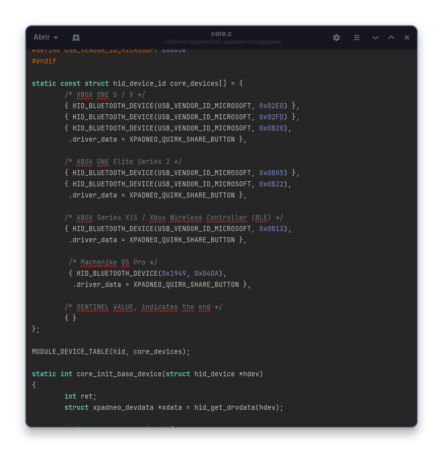

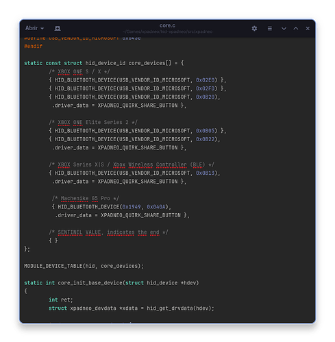

To really fix the Xbox Mode via Bluetooth, it was needed to add the controller IDs to the code of xpadneo driver, and then patch the modded driver, via dkms. After editing, the driver can be installed as usual.
Text to the patch
/xpadneo/hid-xpadneo/src/xpadneo/core.c
/* Machenike G5 Pro */
{ HID_BLUETOOTH_DEVICE(0x1949, 0x040A),
.driver_data = XPADNEO_QUIRK_SHARE_BUTTON },
I was able to reproduce all those steps usb and bt in two Zorin 18 installations, this bluetooth patch method also works for Fedora.
