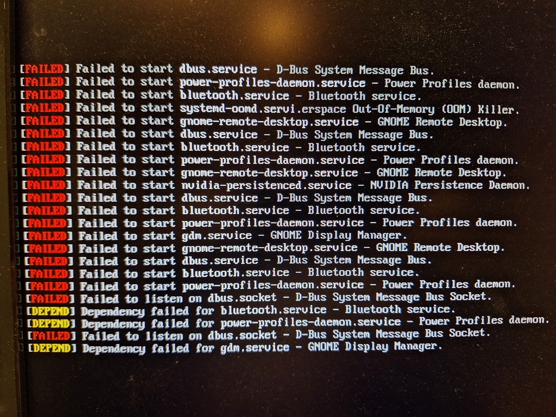

Multiple service failures during boot - fresh install
Ryzen5600X
Nvidia RTX 3060
Secure Boot: off
During boot I have multiple service failures (as shown) with no indication on what to do... This is with "quiet splash" replaced with "nomodeset"
Dual booted with Win11 (this works fine as far as it seems)
What am I missing?
The failures seem to begin at d-bus.

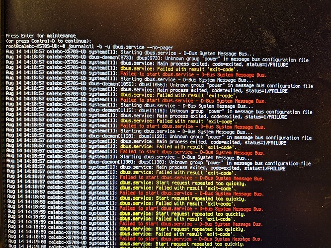

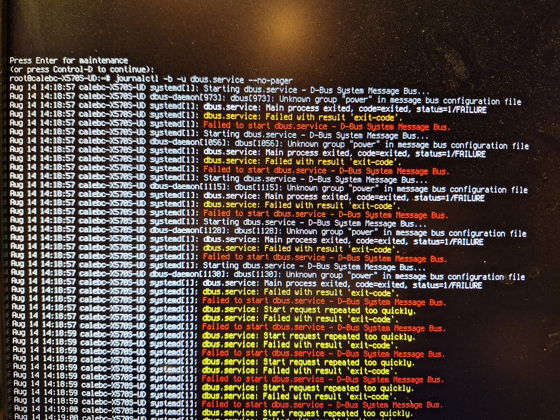

What is your terminal output for:
journalctl -b -u dbus.service --no-pager
Unknown group "power" in message bus configuration
Yes... Zorin OS does not include a group named "power." Have you installed then removed any software prior to this that might have introduced that configuration?
While not ideal, you could simply create a "power" group to satisfy that.
Or remove that group from the configuration in /etc/dbus-1
No software additions or uninstalls, it is a fresh install off the 18.1 iso from the site. I have created the power group just to see, but now it just fails with:
dbus.service: Main process exited, code=exited, status=1/FAILURE
I will try another reinstall from a fresh iso again, but not super hopeful...
