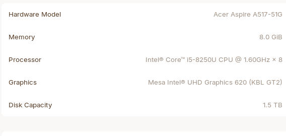

I have an Acer laptop with integrated graphics and a Nvidia MX150 graphics card. No matter what I do, I cannot get it to recognize or switch to the card.
I installed Zorin 16 with the "modern graphics" version before upgrading with the upgrader, went to the additional drivers settings and tried 2 different ones, disabled secure boot, and the Nvidia Server X app is installed, but there are no card details only "Application Profiles" and "nvidia-settings-configuration".

No errors, and no changes. I am verifying by checking the "About" section in the settings. Graphics still says: Mesa Intel® UHD Graphics 620 (KBL GT2), which is my integrated graphics.
