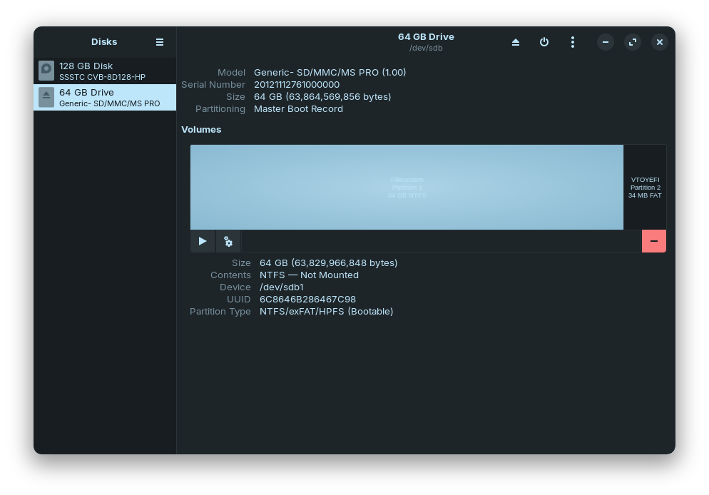

Plug in the SD Card and open ''Disks''. If Your Card is detected there, click on it and post a Picture of it. that could be helpful.
Shouldn't Disks not detect Your SD Card, open the Terminal and type sudo apt install gparted and then open it. Got to the upper right Side and click on the Dropdown Menu and choose Your SD Card and then post a Picture of it.

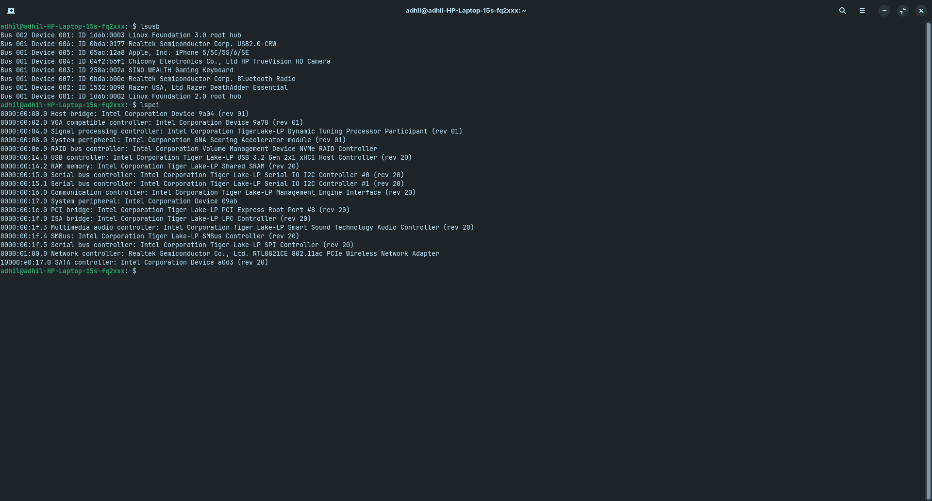

Alright - so a lil more intense now..
What's the terminal output of
lsusb
and
lspci

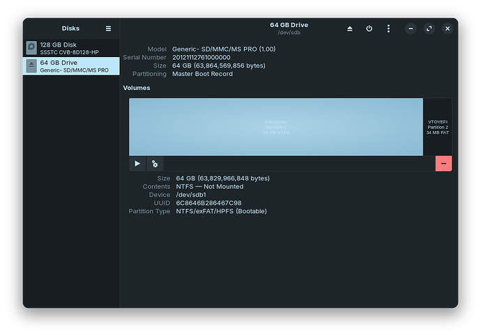

I see the disk is attached, not mounted, verified as NTFS.. At least you got that far lol my iMac late 2015 SD reader is non-existent in Zorin or any other distro ![]()
Ah, that is interesting. You have there at the right Side a small Partition called ''VTOYEFI''. Maybe I'm remember wrong, but isn't this from Ventoy? Do You have Ventoy installed on it?
If You shouldn't need that, I would soggest to delete that. And if there are no Data on it, format the whole Card again. Depending if You need it for Windows and Linux, You should use ext4 when only for Linux. when for Linux and Windows NTFS.

i have deleted ventoy a while ago but also i have VERY important back ups in that drive so i cant delete it (3 years of minecraft hardcore) and an app im building
that didnt work
But it seems not entirely because of the still existing Partition. I would suggest to delete the Ventoy Partition. But when You have important Data on the Card ... I would say now, that You could copy the Data but when it don't get mounted ...
How is it on other OS'? Does it work for Example on Windows? If yes and you have the Possibility to use a Windows PC, You could plug in the Card, copy the Data to save them and then You could wipe the whole Card and format it.
