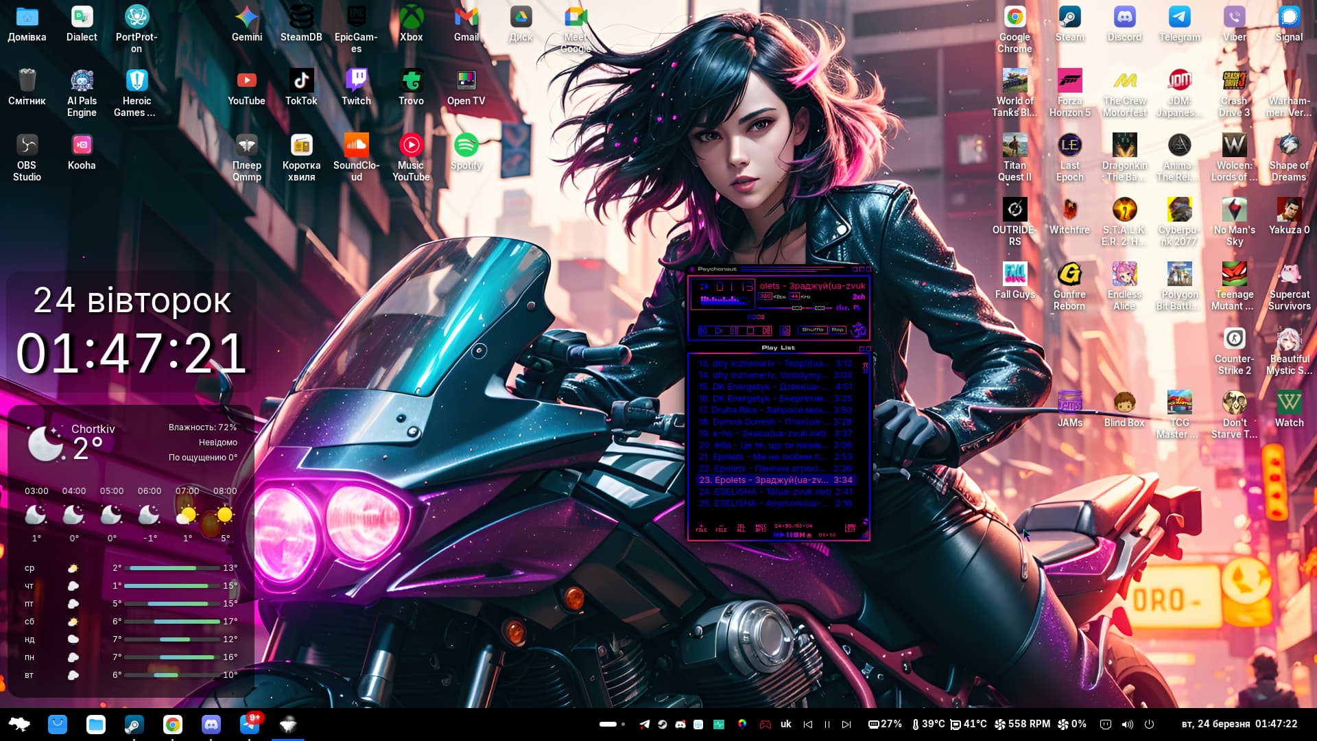

My settings and experience using the system
Hello everyone, share your settings for ZorinOS18.
Unfortunately, you can't upload the relevant files here, so as not to write each step.
I'll just share my settings.
This is not all the settings but let it be, I doubt you need anything more.

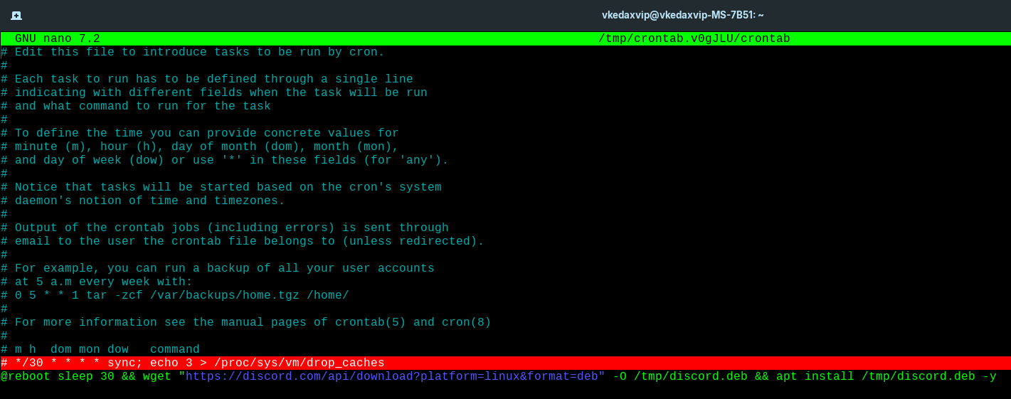

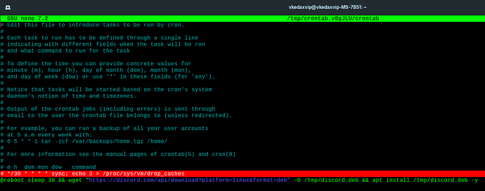

If you want the system to run updates itself every time you turn it on and you don't have to manually enter up-discord at all, do this:
sudo crontab -e
if it's your first time, choose 1 (nano).
Insert at the very end:
@reboot sleep 30 && wget "https://discord.com/api/download?platform=linux&format=deb" -O /tmp/discord.deb && apt install /tmp/discord.deb -y
Ctrl + O,Enter,Ctrl + X

Now about RAM:
sudo crontab -e
If this is your first time doing this, the system will ask you which editor to use. The simplest is nano (usually number 1).
Scroll to the bottom of the file using the keys on your keyboard and insert this line:
*/30 * * * * sync; echo 3 > /proc/sys/vm/drop_caches
this means that cleaning will occur every 30 minutes.
This command will now "dump" everything Linux considers non-urgent from memory every 30 minutes. If you experience a sudden stutter (freeze) for 1-2 seconds at exactly 00 or 30 minutes of every hour while playing a game, this is the script that is working.

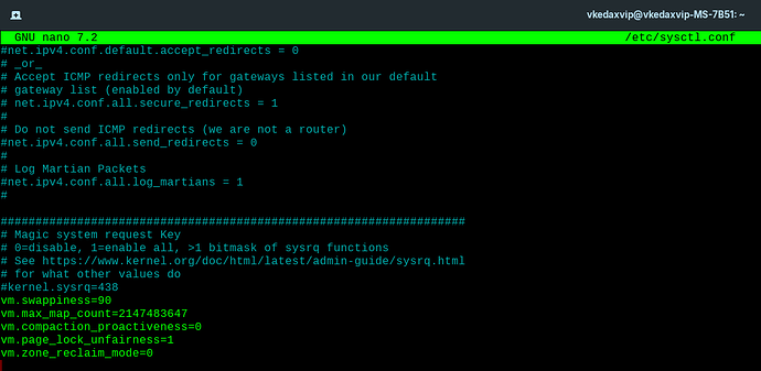

Open the configuration file:

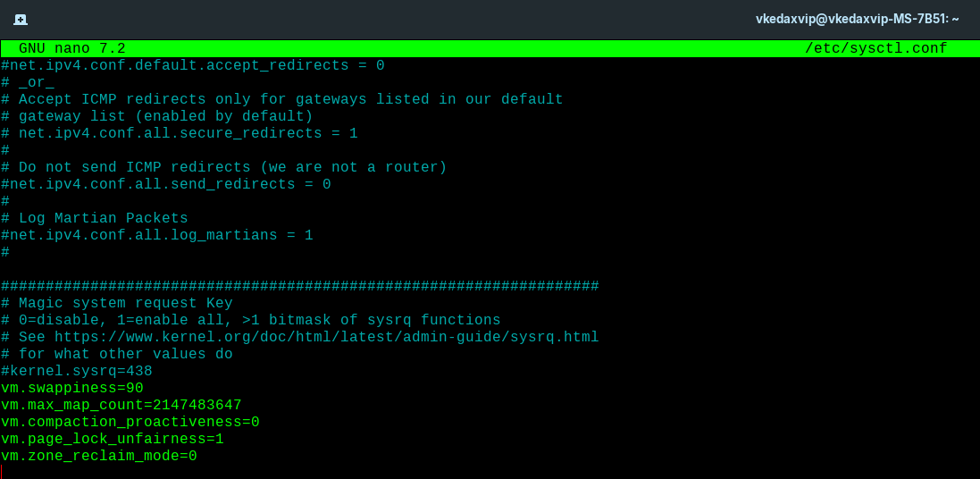

sudo nano /etc/sysctl.conf
Add a line to the very end:
vm.swappiness=90
vm.max_map_count=2147483647
vm.compaction_proactiveness=0
vm.page_lock_unfairness=1
vm.zone_reclaim_mode=0
Ctrl+O,Enter,Ctrl+X.
Apply immediately:
sudo sysctl -p

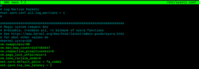

SOLUTIONS WITH PACKETS AND PACKET QUEUES
add these lines at the end:
net.core.default_qdisc = fq_codel
net.ipv4.tcp_low_latency = 1
Ctrl+O,Enter,Ctrl+X
Activate:
sudo sysctl -p
Audit:
sysctl net.core.default_qdisc net.ipv4.tcp_low_latency

You could always download Zorin 6 and earlier to get the then circular menu button to replace the hard angular hexagon of the Saturn North Pole symbol.
CHANGING THE STARTUP ANIMATION
Copying to the system:
  1. sudo cp -r /home/vkedaxvip/Downloads/steamdeck /usr/share/plymouth/themes/
ATTENTION YOU CAN SHORT THE FIRST COMMAND BY STARTING THE TERMINAL FROM THE REQUIRED FOLDER AND SPECIFYING THE FOLDER IMMEDIATELY:
sudo cp -r steamdeck /usr/share/plymouth/themes/

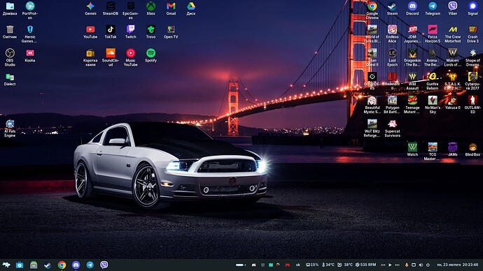

starting my system
