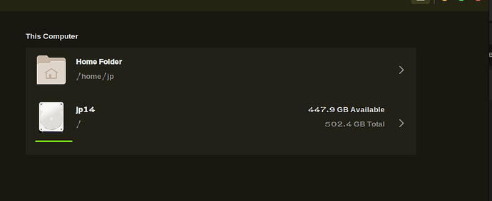

my .var files show 6.9 MB?
why ?

my output for sudo du -sh /var/*
jp@jp14:~$ sudo du -sh /var/*
[sudo] password for jp:
5.2M /var/backups
366M /var/cache
4.0K /var/crash
3.0G /var/lib
4.0K /var/local
20K /var/lock
12M /var/log
4.0K /var/mail
4.0K /var/metrics
4.0K /var/opt
0 /var/run
96K /var/snap
132K /var/spool
60K /var/tmp
jp@jp14:~$

Note that /home/jp/.var is not the same as /var at the root of the filesystem. But everything looks fine from what I see on your system.
