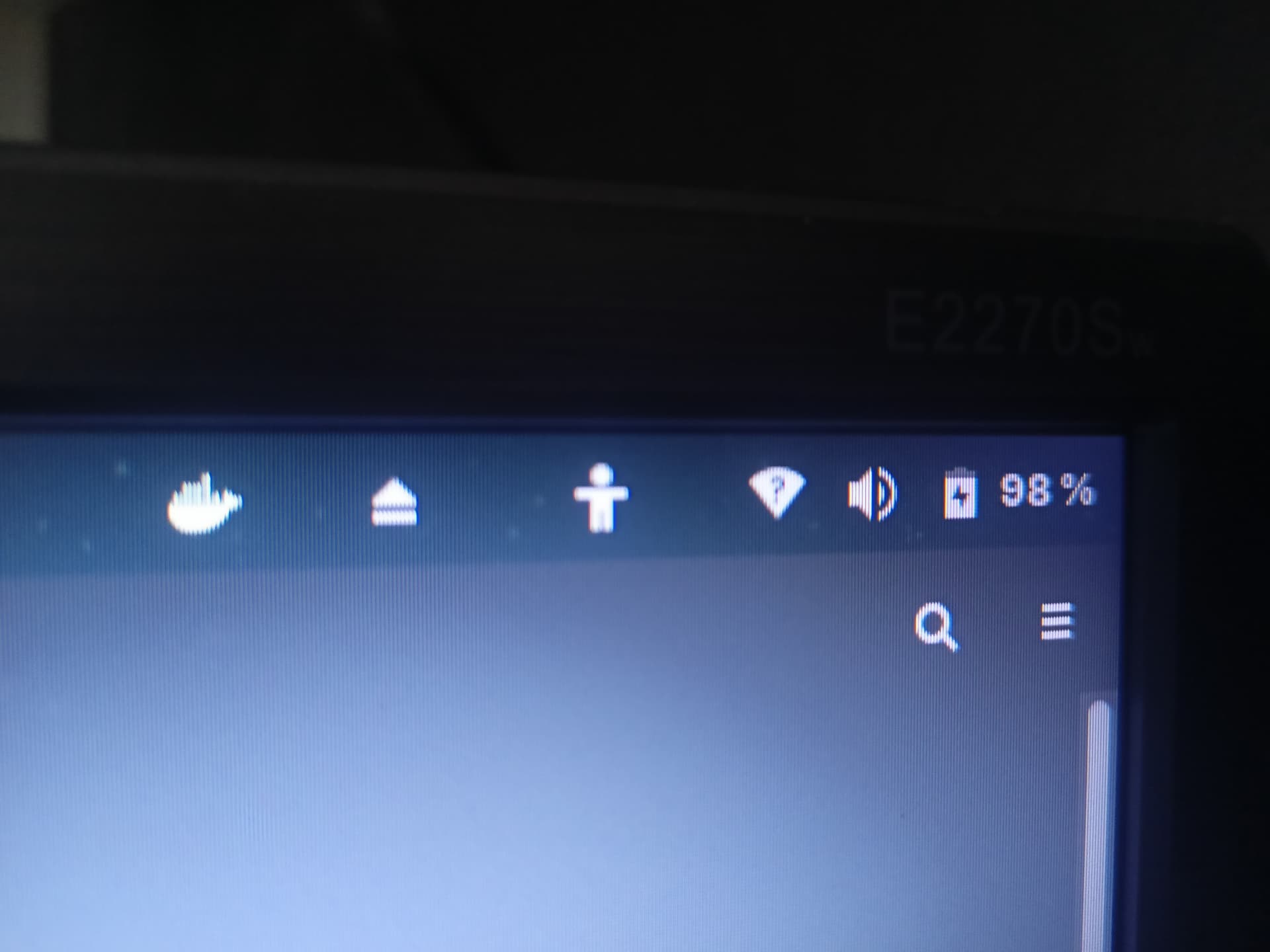

My wifi is connected but not working ..a question mark is randomly appears on the wifi icon. Please help me, I don't wanna go back to windows, I use zorin 17 pro

Connected through Wi-Fi only means there's a connection between the computer and the router but not necessarily internet access. First, confirm that your device really doesn't have any internet access by trying to visit any websites, running software updates or other programs that need internet access. If some things work but not others, that already may give a clue as to what's wrong.

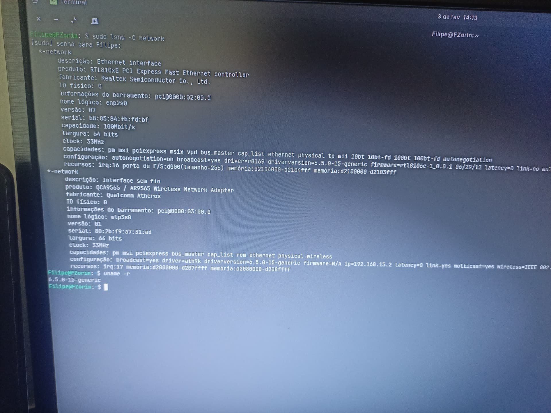

If you run ip a in a terminal do you see an IP address assigned to the either ethernet or wireless interface? If you do, try to ping another device on the network see if that at least works.

sudo modprobe -v ath9k
Get it working?
I've tried 2-3 times nothing changes, the command don't show any comment
This usually means that the module is already loaded...
Let's try
sudo modprobe -r ath9k
sudo modprobe ath9k

Can you show the output of:
grep '' /sys/module/ath9k/parameters/*
I think it's worth trying this out:
Edit file /etc/modprobe.d/ath9k.conf (create if needed) and add a new line:
options ath9k bt_ant_diversity=1, reboot and try again.
