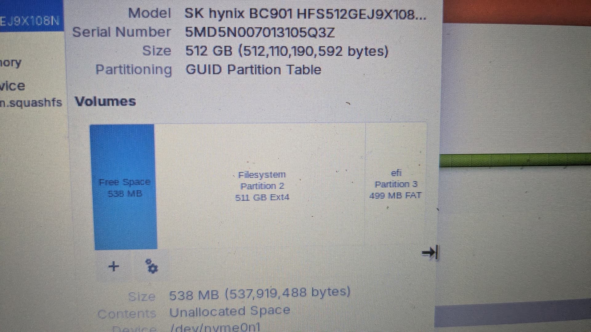

Today i thought of installing kubuntu and after installing it i found out that I didn't like it so i booted from zorin Live USB and installed zorin... After that I opened timeshift and I did a system restore... The problem was that I was at mid run locked out to zorin lockscreen and I was unable to unlock. Thats when my pc froze. I forced a reboot and I was brought to grub minimal shell... So I tried re installing zorin, doing restore again but this time it rebooted itself before finishing... At that moment I got same grub shell... Then after re gointto zorin live usb I formatted my ssd so to clean all of that mess and this is my partition table
But when I proceed to the install I got
The attempt to mount a file system with type vfat at /boot/efi failed
So I was basically left with not knowing what to do... Secure boot was always enabled even before the os change...

@Aravisian
I would do a clean install, without restoring TimeShift.
Then, move over the backup files from the Home Directory that you saved, Except For The ~/.config and /.local folders.
@Aravisian
Ok I did a clean install and everything now works... I will most likely copy the home directory from timeshift to mine, this is where my wine, everything lives
