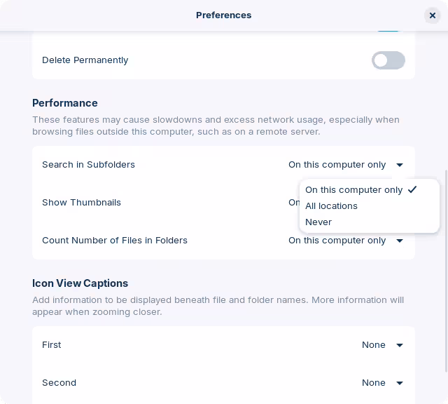

I'm not sure if this is the same setting that you've set through dconf-editor, but Nautilus has one for this under Preferences → Performance → Search in Subfolders. Set it to All locations, and see if that makes any difference.
@zenzen thank you for this suggestion, yes I did it - that's why tracker got those drive indexed and searchable including file content - in the terminal. There must be some problem on nautilus <-> tracker connection. For now I can live with that :slight_smile:
