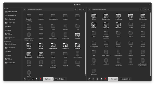

I tried it abit with expand and shrink and it works well. There is a little Gap at the End but I wouldn't find it annoying:
So, at least for me it runs fine so far.

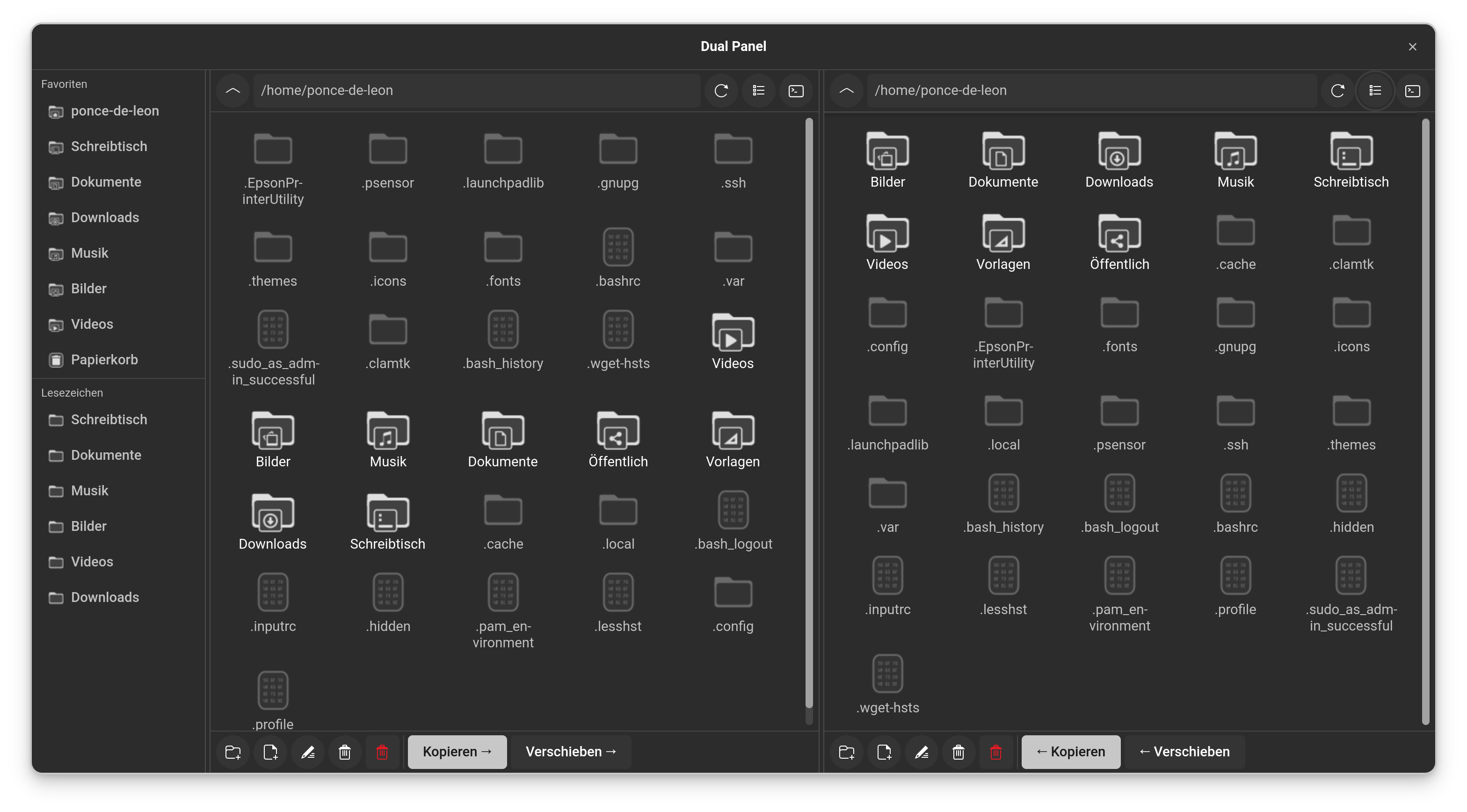

I received the Updates and now I have an Issue with the Dual Panel. The Order is wrong. The Folders and Files are not ordered right. To show it on a Picture (fortunately the Dual Panel has 2 Panels, so I can show before and after in one):
On the left Side, you see the Issue. It isn't sorted right. I can make it right when I click on the Indicator for switching the View Options. So, I switch to List View where it is wrong, too and then again to this View on the Picture and it is sorted again like You can see on the right Side.
That wasn't before this Update. First, I thought that it might be related to the hidden Files. So, I tested it in my Pictures Folder, too and had the same. And setting it up again doesn't help. When I open the Dual Panel again it goes back to the wrong Sort Order.
