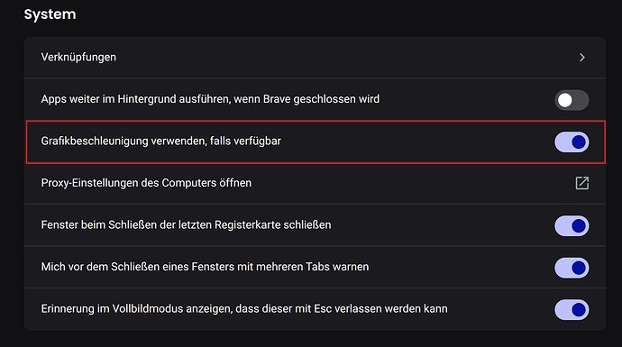

You could try it with disabling Hardware Acceleration in the Settings:
Je ne trouve pas cette option sur mon zorin ![]()
Maybe my Comment was a bit misunderstanding wrote. The Setting is not in Zorin. It is in the Brave Settings. In the Browser.
Mais dès que j'ouvre brave, le pc plante. Obliger d'éteindre en faisant un appui long sur le bouton marche/arrêt
Ah, okay. Then You could try it over the Terminal. Hopefully this will work without directly freeze. Type in Terminal:
brave-browser --disable-gpu
That should start the Browser with disabled Hardware Acceleration.
