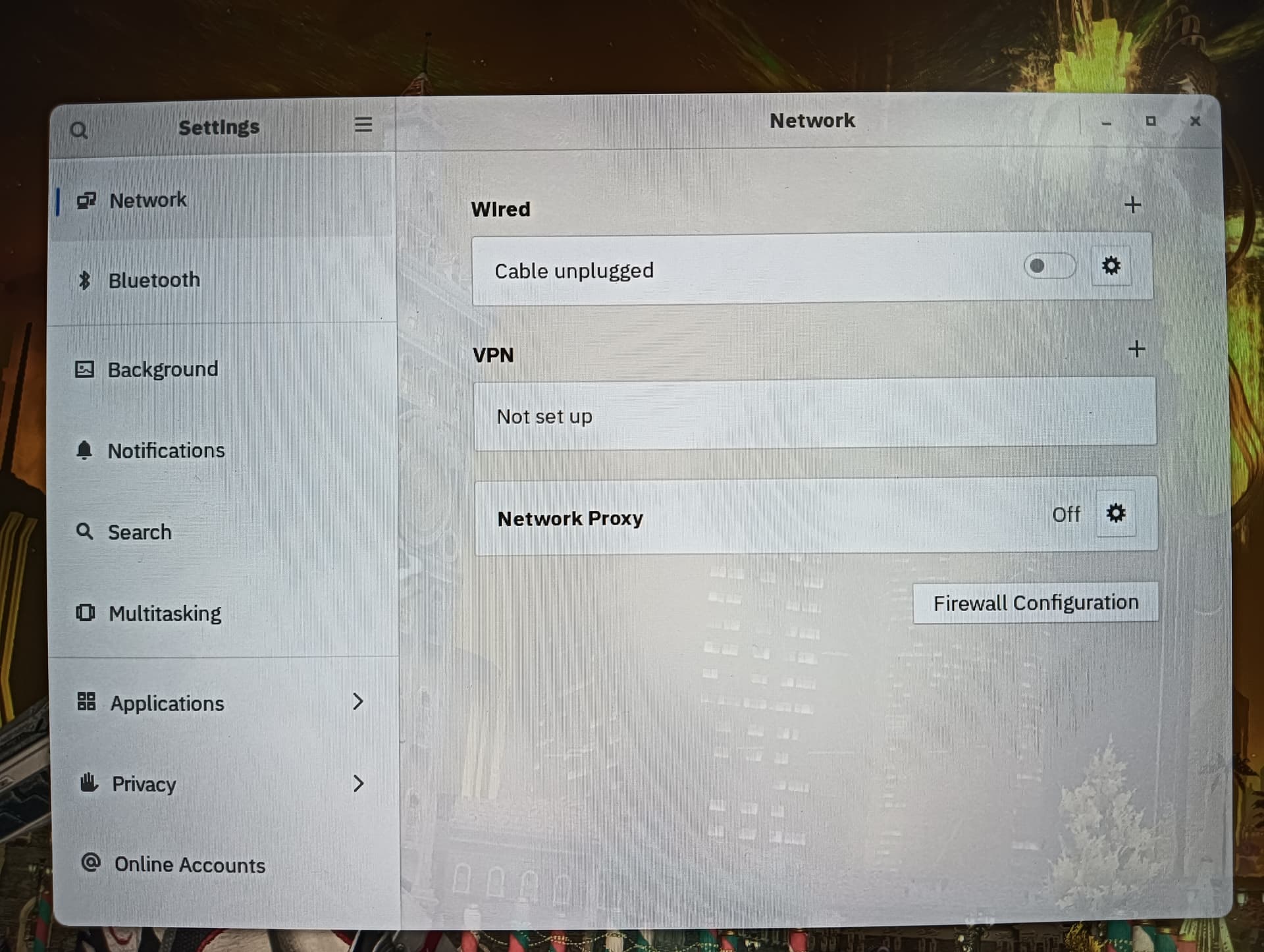

Need help! Everything wifi related is completely gone
My video suddenly stops playing and I lose all connection from all network availabe. Immediately after restarting all the wifi options are gone and I don't know how to fix this

Unfortunately it does not work. It took a while to get to desktop but the problem is still there

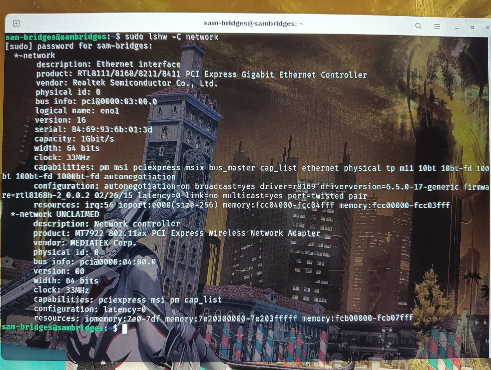

Which wifi card are you using?
Have you run in terminal
sudo lshw -C network

MT7922 MediaTek - stopped working after an upgrade - seems likely that this is due to an upgraded kernel.
You can check this easily
Reboot zorin OS - tap tab or esc if using EFI boot or if using Legacy MBR boot, hold left shift key - to reach the Grub menu.
At the Grub menu, select to boot Zorin from the Previous kernel, not the top one.
Do not use the one followed by (Recovery)
Just the standard Zorin OS on (kernel number)
Once booted, check if wifi is working.
If it is, you can set that working kernel as default - or try other kernels.
