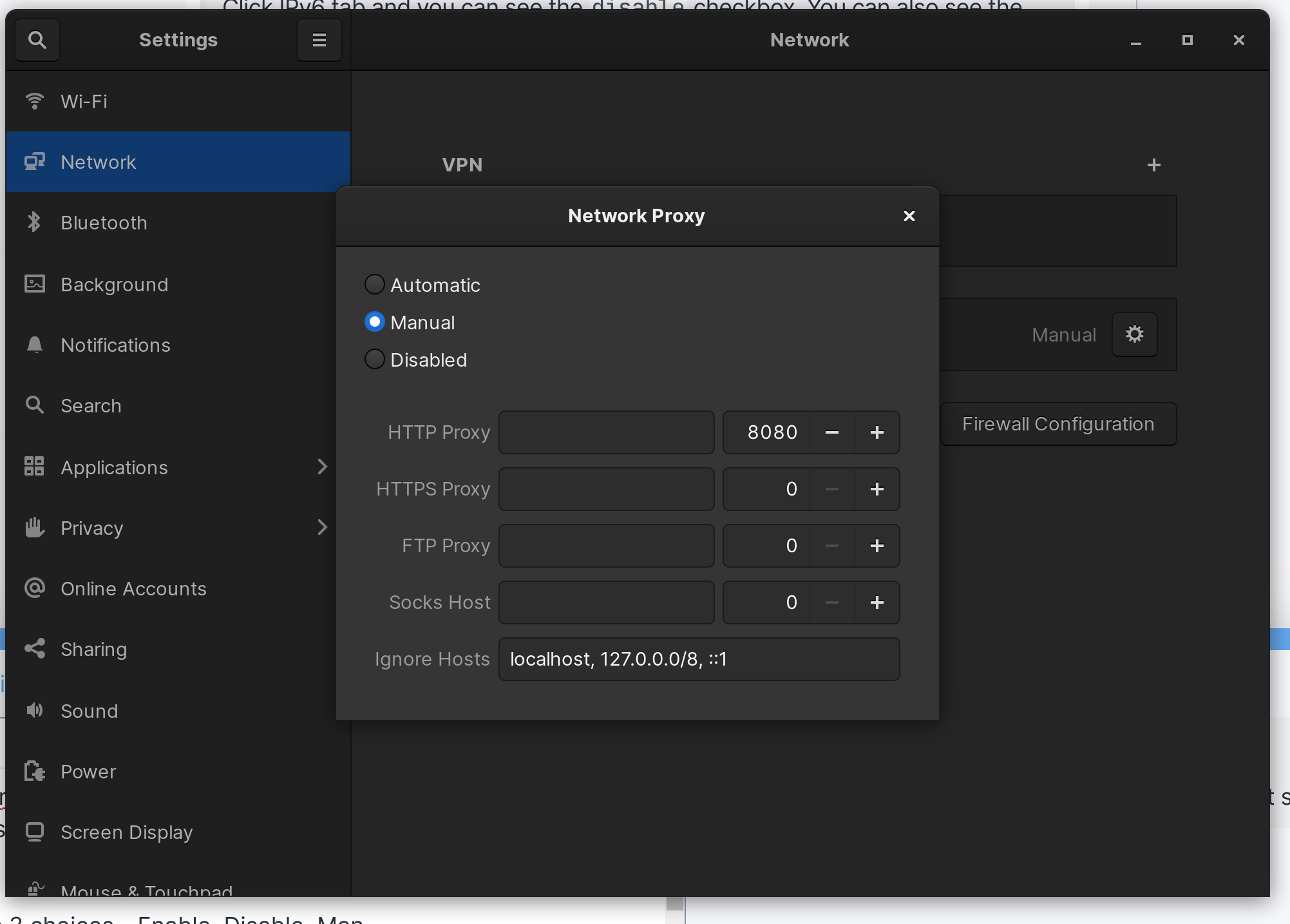

Tink, the settings look legit, to me. Sometimes, for some users, I also recommend disabling ipv6 for various network issues.
You can also change your DNS and your ipv4/ipv6 from Settings GUI.
Open Settings (gnome-control-center) and Select Network or Wifi. In this example, I will select Network. Now, click the settings icon on Wired > cable unplugged (just to the right of the Switch). A pop up window will open with tabs Details, Identity, IPv4, IPv6, Security
Click IPv6 tab and you can see the disable checkbox. You can also see the DNS box, which the same is on the IPv4 tab.
There are additional settings below Wired Connection for VPN setup and for Network Proxy.

Thank you @Aravisian . I went to implement those changes but I seem to be missing some of those GUI settings.
I couldn't find anything about network/IPv4/6 under wifi either.
As do I. It's just that I already paid for this service. What a mistake. :roll_eyes: Proton VPN is fantastic but it's also more than double the cost and is limited to only 5 devices. Was hoping to find something more in my budget that allows for at least 7 devices.
What does the Gear Icon next to the switch (where it says off) reveal?
Only gives 3 choices - Auto, Disable, Manual. Disabled is set by default. If I select Manual, I get this:
Are you using Wifi? If so, what does the Gear Icon reveal for the Wifi ID you are using (Ensure you wait for it to fully load before clicking the gear icon).
Yeppers. That's where is was hiding. As always, I really appreciate the help. Now I'll be able to undo any of those above changes easily. You da best!
