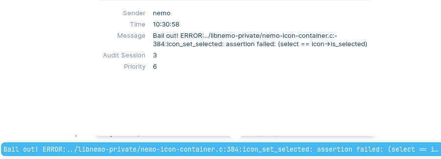

What about this, what if you guys advised me on what I should do when it crashes again, like look at some nemo error logs or something, if such a thing even exists.

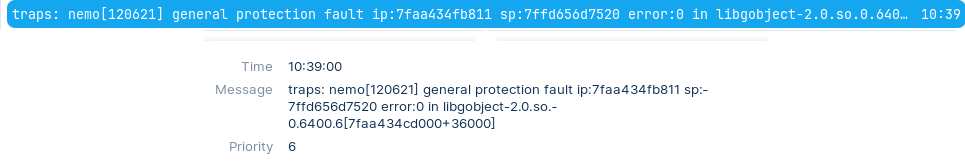

You can specify Nemo in the logs:
journalctl | grep nemo
Please keep in mind - that will produce a lot of output. This is normal. Anyones would with any file manager.
You can truncate with the summery tags or use pastebin to post the output here.

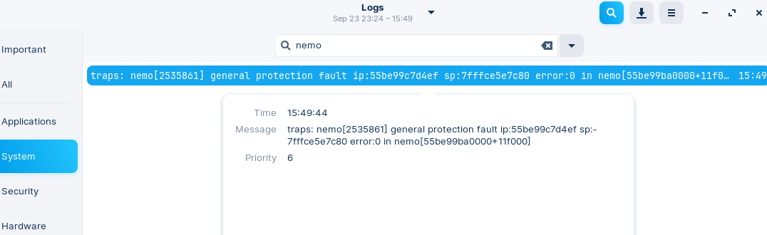

Let's try:
addr2line -e /usr/bin/nemo 55be99c7d4ef+11f0000
There are many things that can cause a segfault, from memory leak to invalid permissions being accessed.

What ??:0 means is a null output. It could mean we are giving the wrong address for the line in the Nemo Binary file.
But can you run
file /usr/bin/nemo
If that says Stripped, then it means we cannot use the addr2line command option because the Nemo devs removed debugging symbols.

It says stripped - So I believe this is why the command continued giving null output. The debugging symbols are stripped out.
