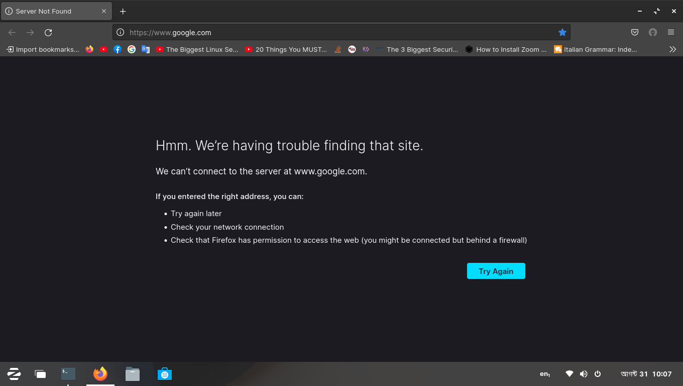

Last night suddenly it failed to connect to the internet. I tried various process showed on youtube but nothing works. I reset my adapter, wifi router, my connection is all right but only Zorin 16 is failed to connect since last night. I don't understand what to do? Please help me for find a solution and connect with the internet again. thank you for your kind support.
