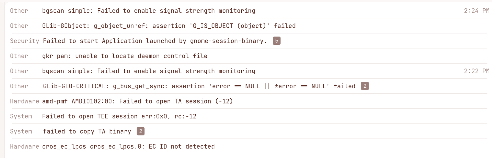

Okay, when this happens, open after this please the ''Logs'' App. It shows Log Entries from everything. Post a Screenshot of it here. Maybe there is something that doesn't load right or an Error.
What is in the power saving settings that you think should be changed?
I think this is it. What do you think?
