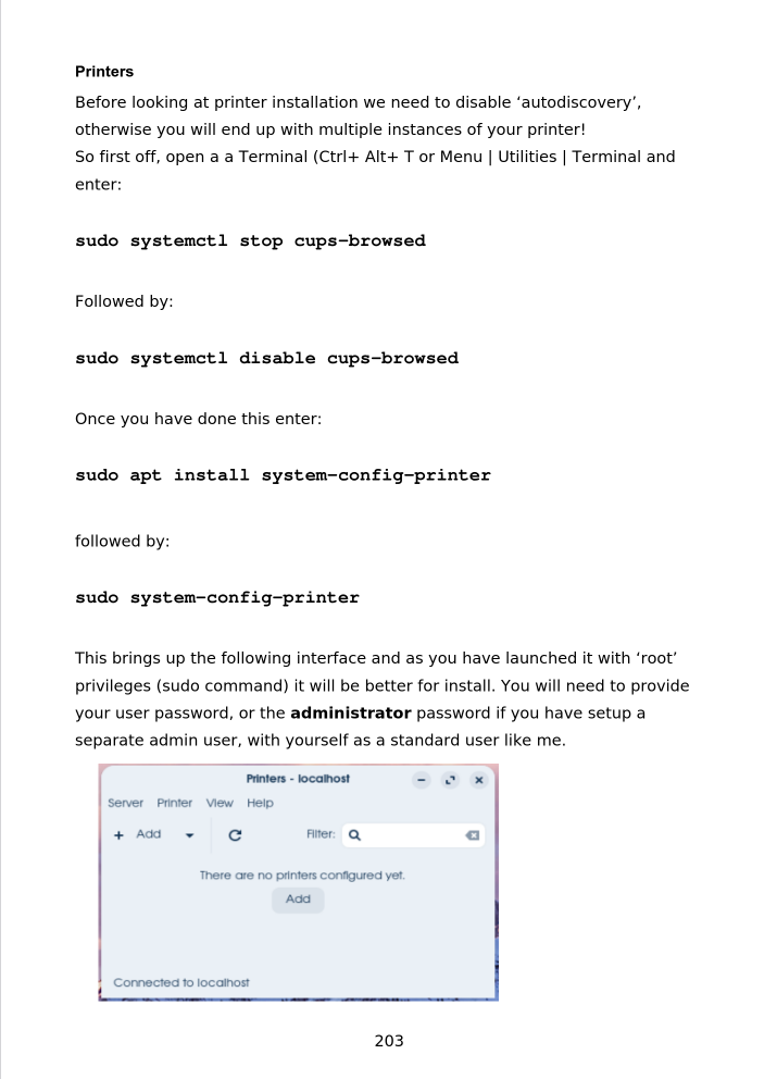

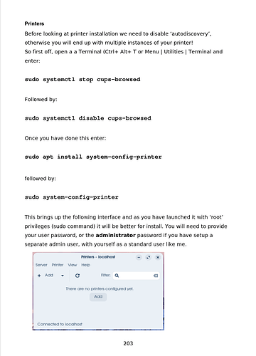

From the unofficial manual for 18 Core:

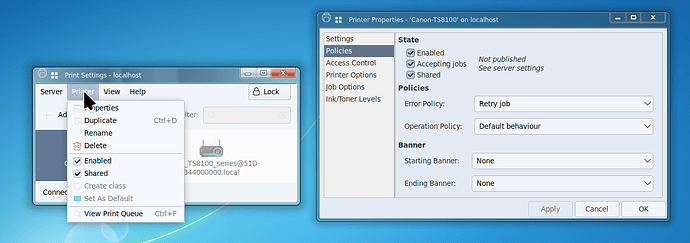

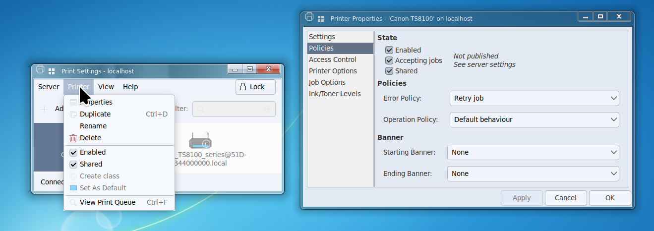

if the printer is plugged into another pc, open http://localhost:631 on that pc and check the queue under Printers. enable Share This Printer in Administration, then add it from Zorin with ipp://host-ip:631/printers/queue.

If the Canon printer is connected directly to one PC by USB, it usually won’t automatically appear on the LAN like a network printer. You generally need to enable printer sharing on the computer it’s connected to, then add it from the other machine using the shared printer or its network address. Checking the printer settings and CUPS on Linux may also help identify whether sharing is enabled.
