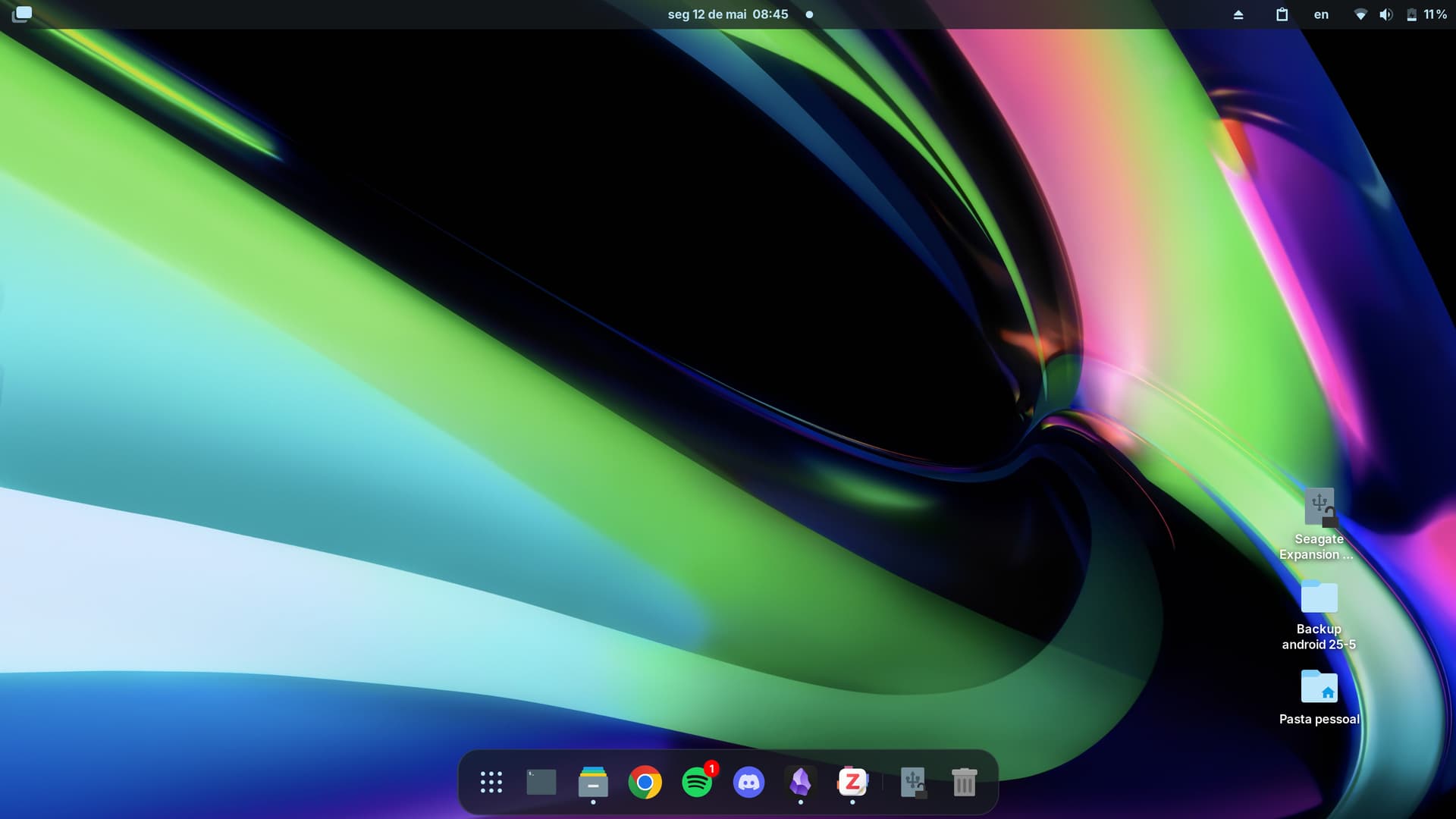

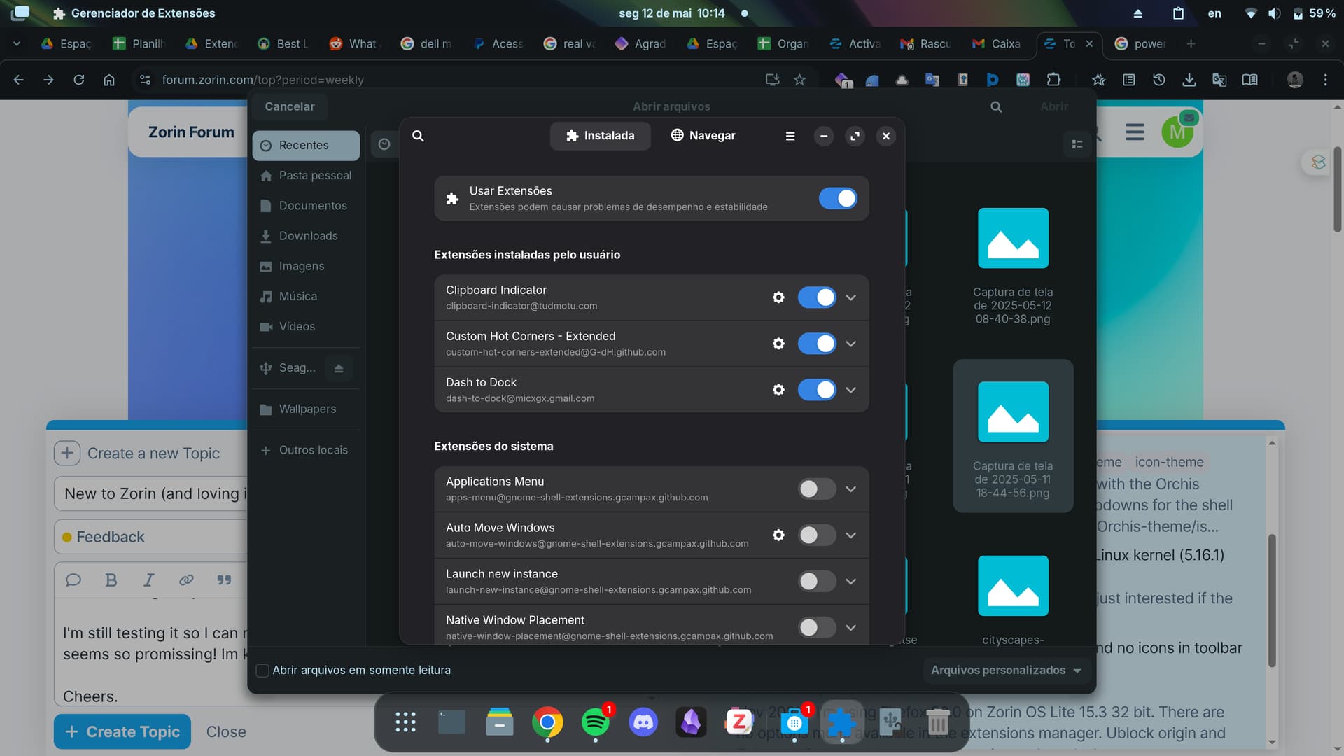

  • The UI is modern and optimized out of the box in comparison to the vanilla GNOME Shell. I had to install very few extensions to make it perfect for me. It's absolutely gorgeous! (Screenshots attached)

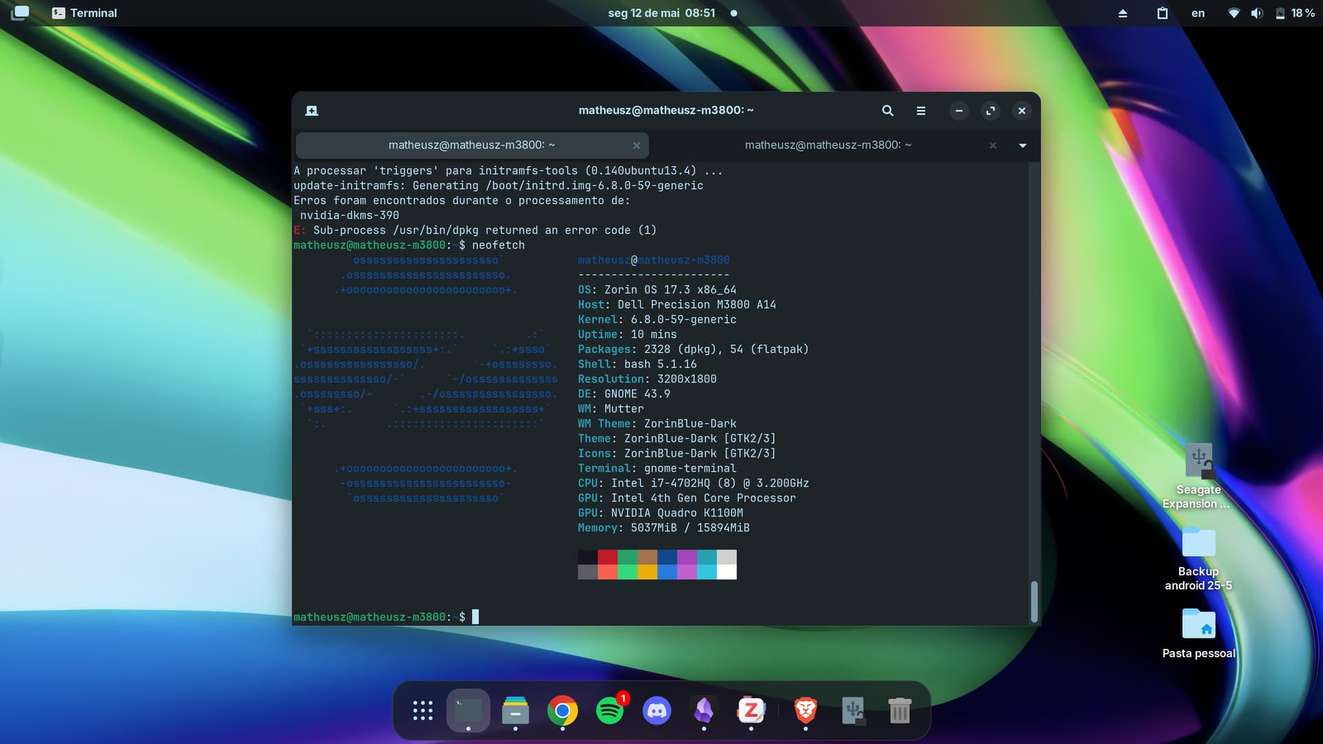

  • Though everything seems fine so far, the NVIDIA drivers still don't work as expected here. The only distro that managed to install them correctly was Ubuntu. I'm sticking with the open-source driver as I haven't noticed any slowdown in system or app performance (Chrome is a bit slow on the first startup and when rendering a few pages - own Google pages, lol, yeah, don't judge me! I mainly use Chrome because it's synced with my university account and it's so handy right now... but I do use Firefox for personal use).

Wenn Sie den Nvidia-Treiber verwenden möchten, können Sie entweder den Kernel 5.15 installieren (er ist im Repository enthalten) oder das ppa von kelebek333 hinzufügen.
I think the Problem ist the Driver Version 390. It isn't compatible with the 6.8 Kernel. So, You could install an older Kernel like @Forpli already wrote or use the Repo.

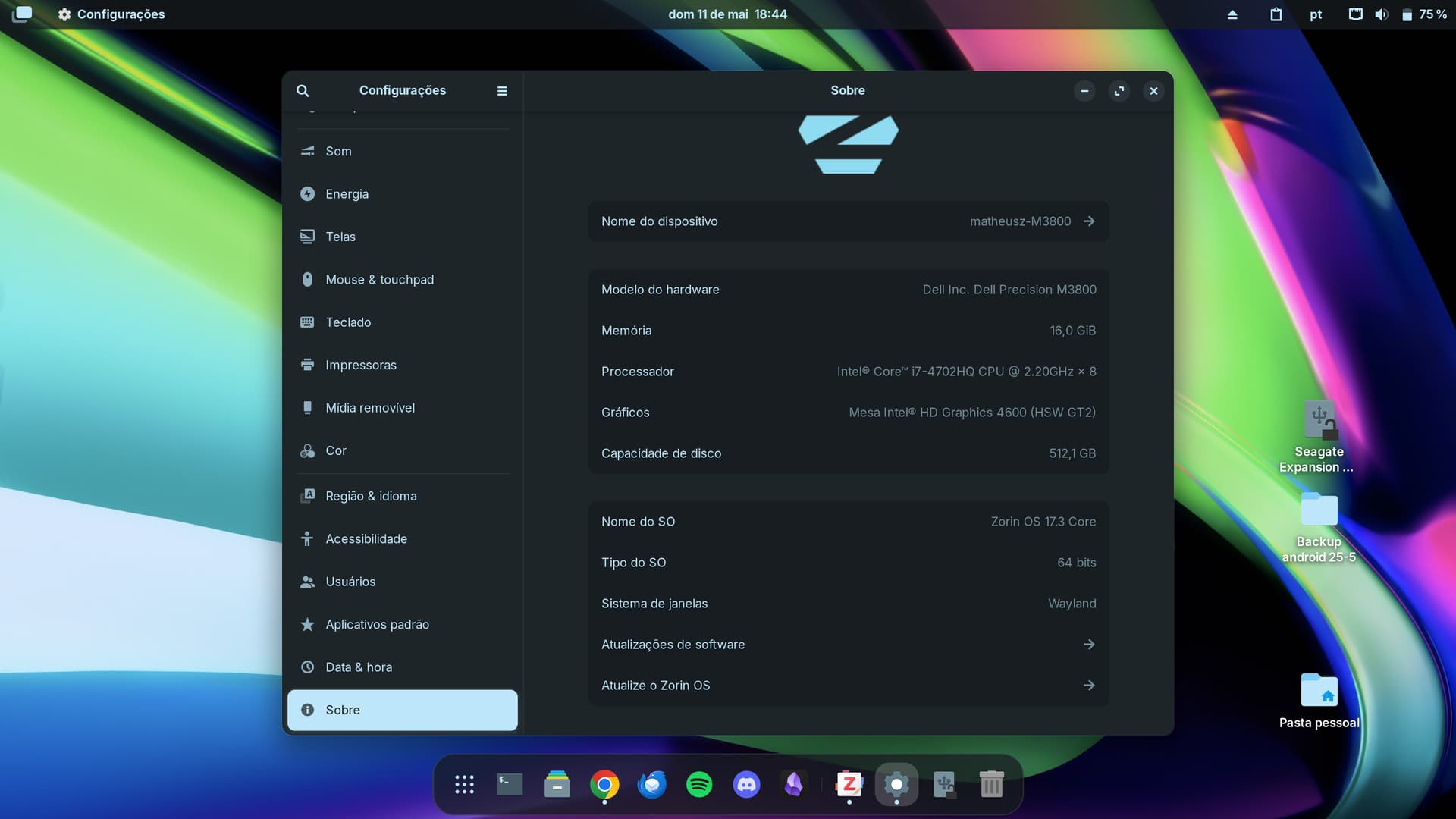

And there is one Thing in Relation: I saw on one of Your Pictures that Your System is running in Wayland. Because the Zorin Desktop has an older Gnome Version, the Wayland Implementation isn't on a Level where it would work well with Nvidia.
So, it would be good to switch to X11/Xorg instead. And that could explain, too why on the Graphics Info Your integrated Intel Graphics is shown and not Your Nvidia Graphics.

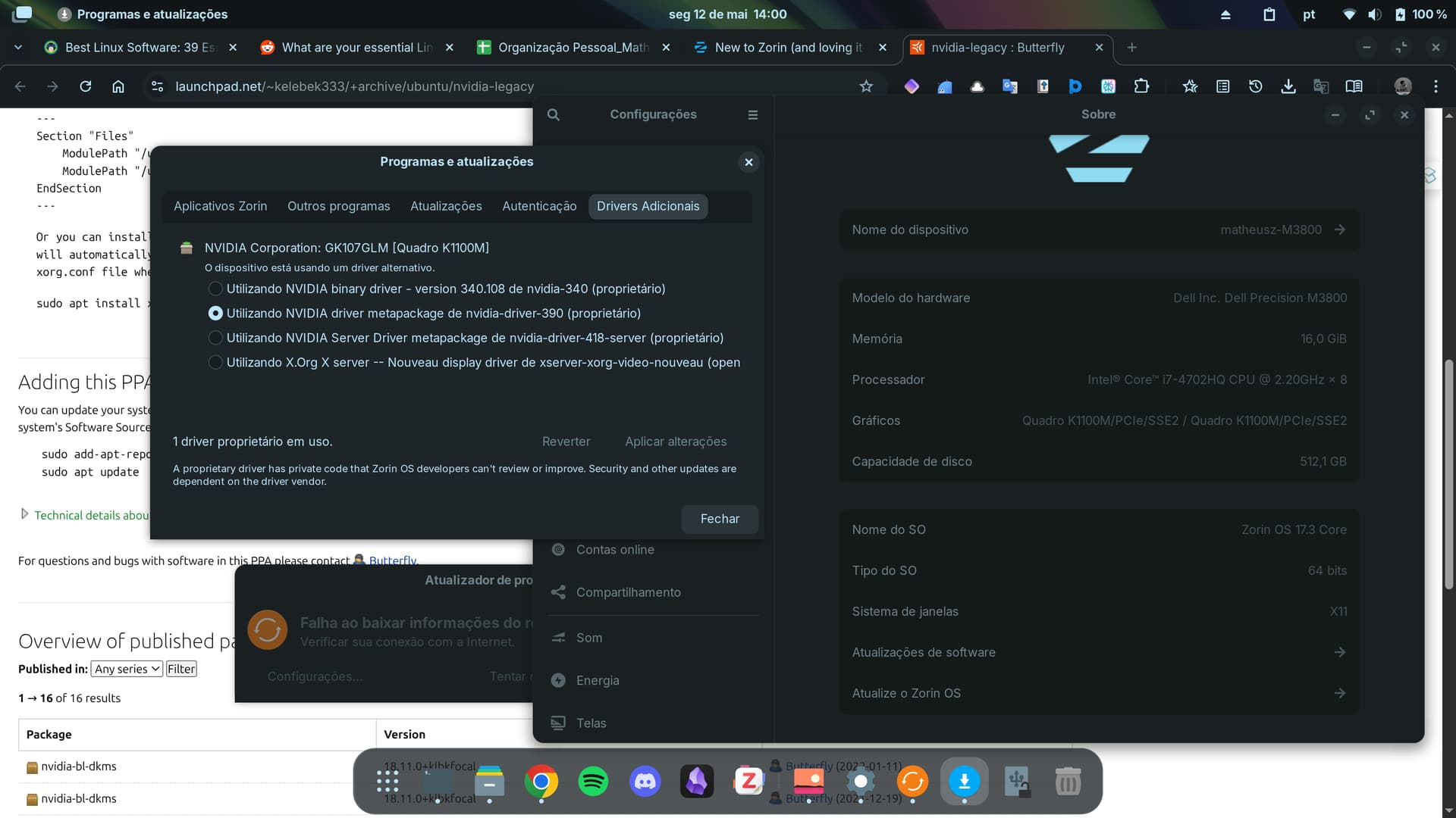

So, I added the PPA and switched to X11. Now the card is correctly loaded, I guess. I haven't noticed any notable performance changes at all, but the CPU usage is definitely lower.
