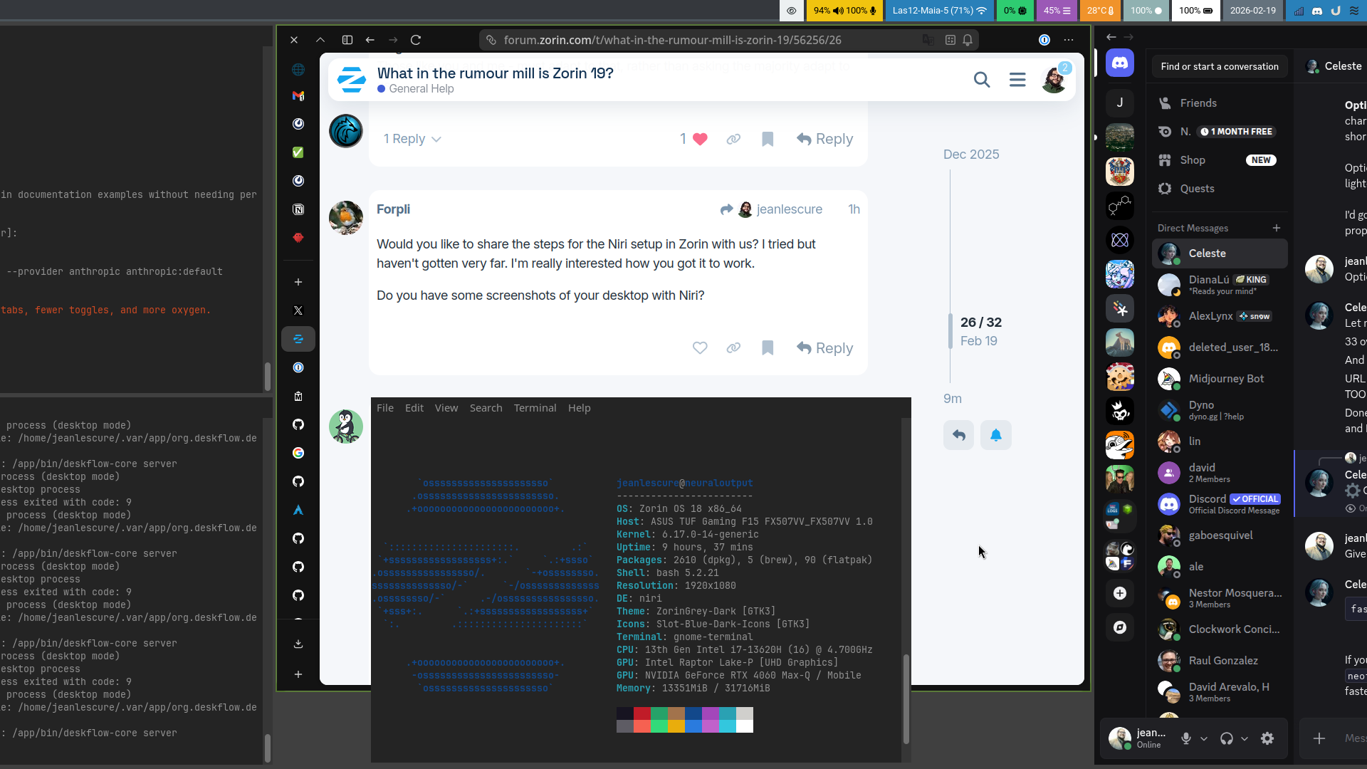

Glad to share my notes, although some things have changed since I last updated them a few hours ago (i.e. I replaced fuzzel with ulauncher):
To run the Niri Wayland compositor on Zorin OS, you will primarily need to
