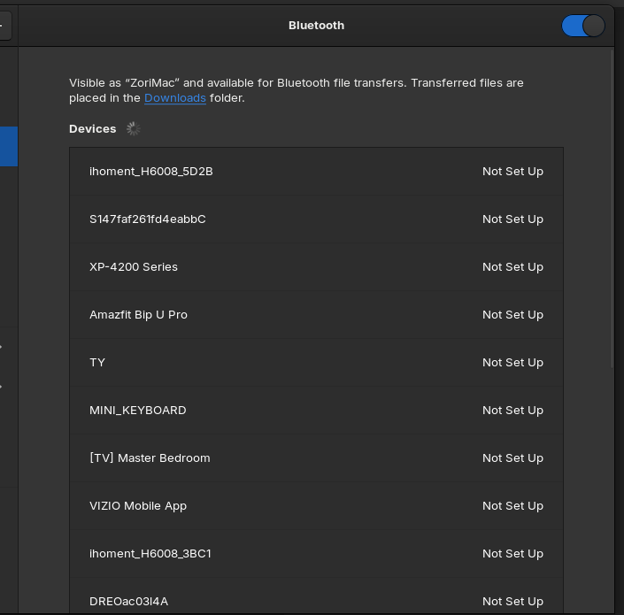

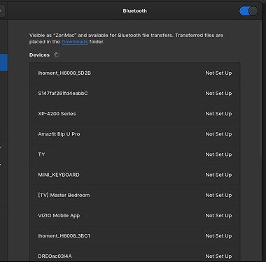

Do you see anything like this in Bluetooth settings?:
From my smartphone I can link to the keyboard and the sound device in bluetooth, but not to my desktop. Now at least I can make sure that bluetooth is turned on.

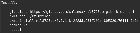

Did you follow these steps from the Readme.md file? (DKMS installer):
Yes :face_exhaling:

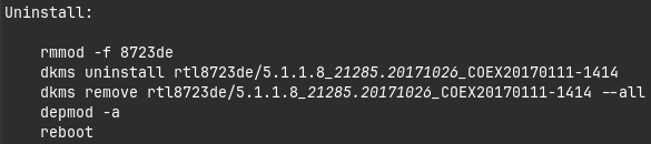

... As again, give that a try and absolutely thank you for being patient.. sometimes this isn't as easy as some other fixes.. And - you may want to uninstall that one driver as stated in the readme.md, first:
Then try installing..

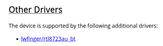

And finally found it - THIS is what I've been looking for... looks like 'Detected' status for Zorin 17.x:
And within that page:
(Link to that driver: GitHub - lwfinger/rtl8723au_bt: Bluetooth driver for RTL8723AE and RTL8723AU)
Maybe... that '8723au' one is the one you need - you tried the 'de' version, and only got to turn it on / off..
