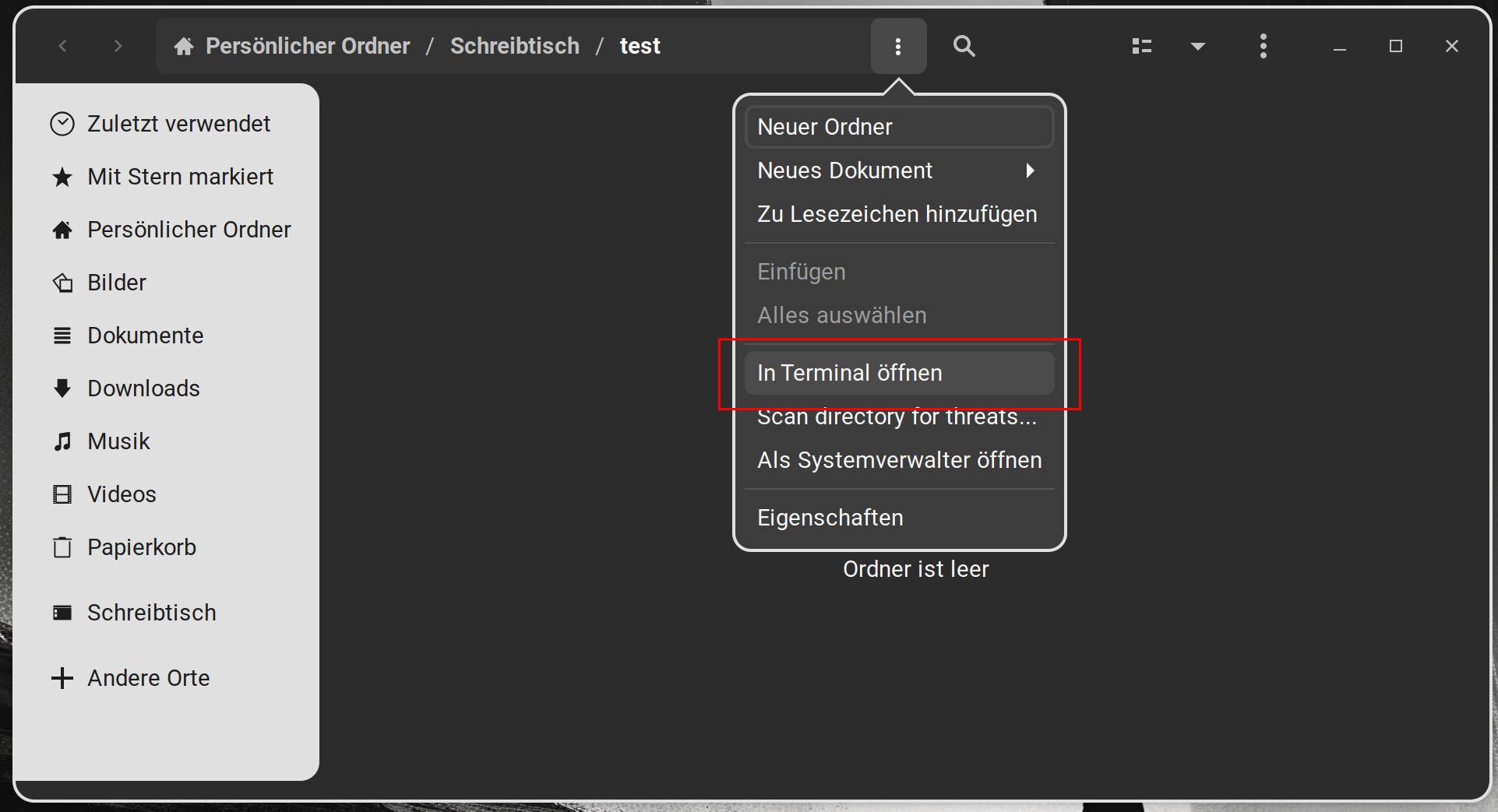

You mean it it possible to open a terminal in an unzipped folder? I can't.
When You have open the Folder with the File Manager, click on the 3 Dots in the Search Bar and choose the Option ''Open in Terminal'':

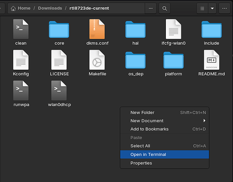

Right click in the folder, then open in terminal:
Or - use the terminal and navigate to that folder.
