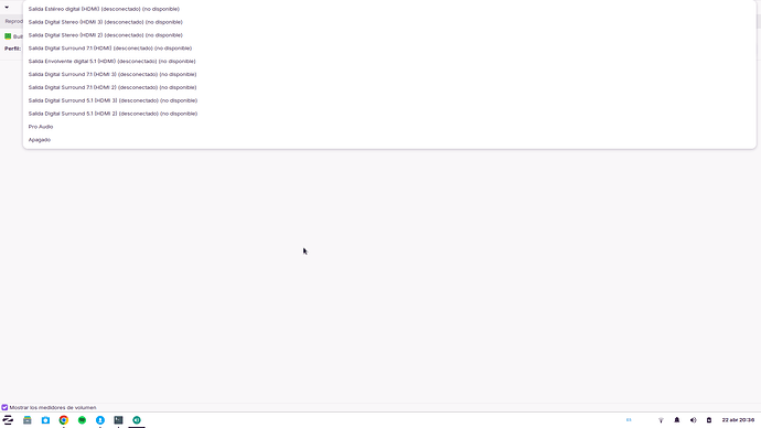

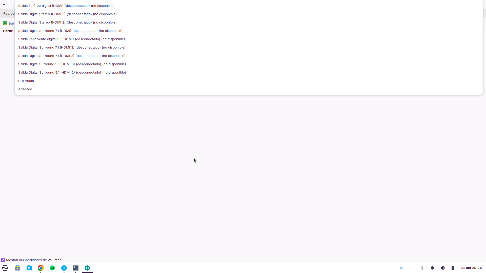

Could You post Screenshots or the Output Tab, the Input Tab and the Configuration Tab from pavucontrol? Maybe You have to expand the Window a bit depending how much Devices are there.
In the input and output tab says there not available and this is the configuration tab of pavucontrol

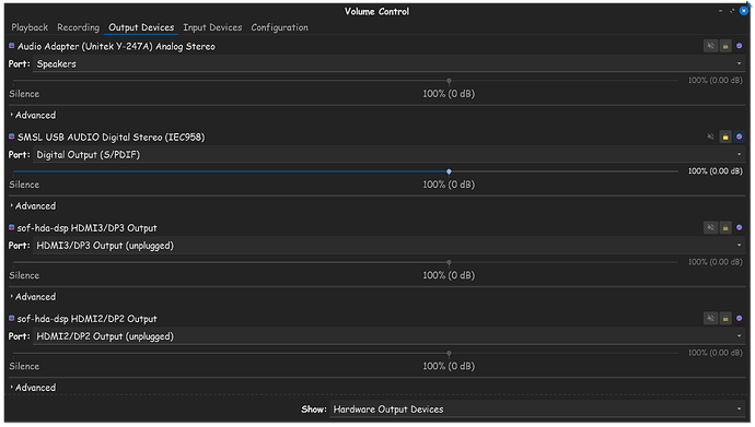

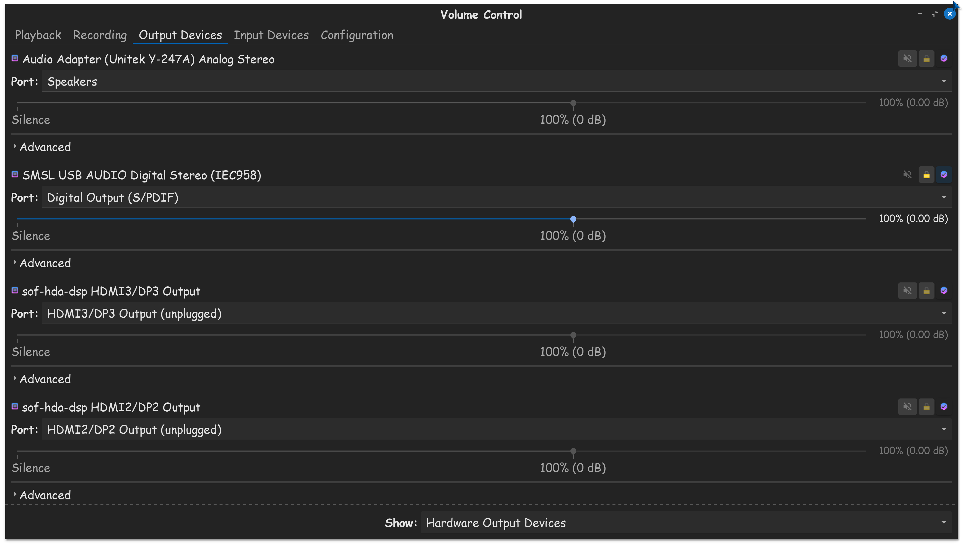

You might want to have a look at your Pulse Audio Volume Control GUI APP.
I used to use the HDMI output source for years, but then I changed my audio setup, and switched to using my external USB DAC.
What I did was, I muted all other output sources I'm not using, and left only the source I am using, unmuted. For reference, your source is muted when the speaker icon on the right is highlighted.
So my advice as follows...
(1) Make sure you see your output source in the list.
(2) Select your output source and set it to default.
(3) Make sure your output source is not muted.
Under Playback tab...
When a browser page, music player APP, or game is producing sound, it should be listed here. Make sure its un-muted, and the volume is up.
Regarding Input Devices tab...
If you are using microphones on your input line, make sure they are selected and defaulted to, and that they are not muted, and your volume is up.
Okay, when I understand it right only the last 2 Options are available as Setup. Did you tried to use these and check if it works?
Yes, i tried but still doesn't work sadly. I gave up and delete Zorin lite, and tried installing Linux mint and the problem is the same. Internal speaker and mic only work or get detected in windows.
