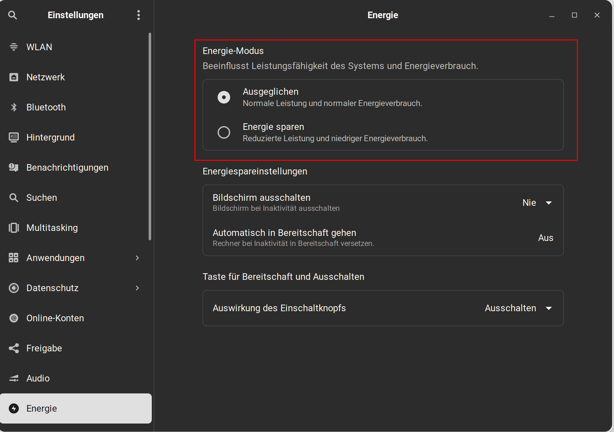

You can find it in the Settings under Energy or Power:

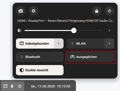

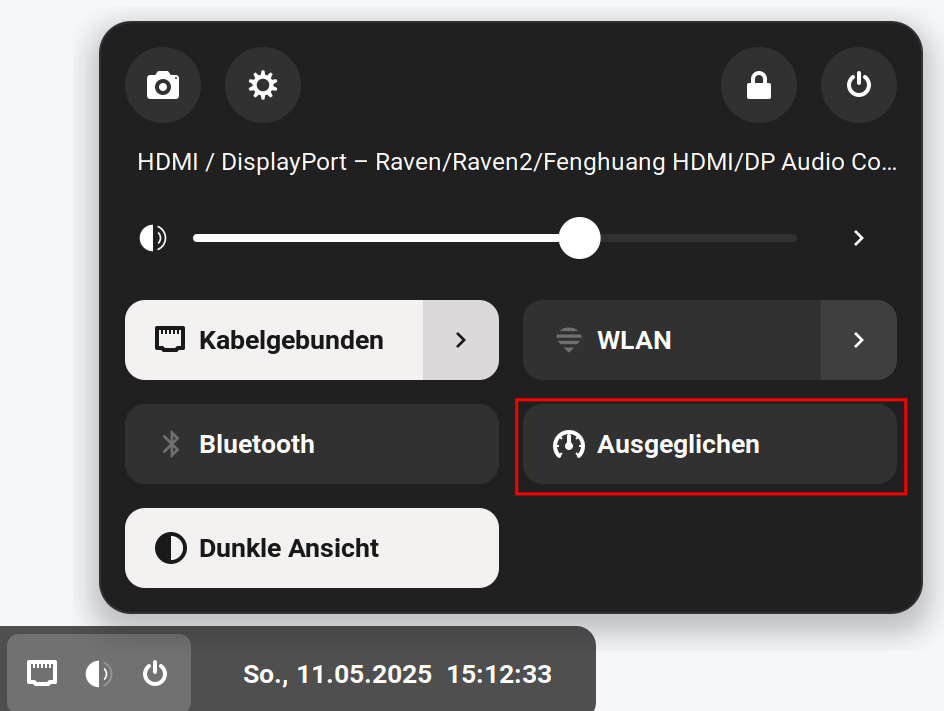

Or in the Quick Settings in the Taskbar:
