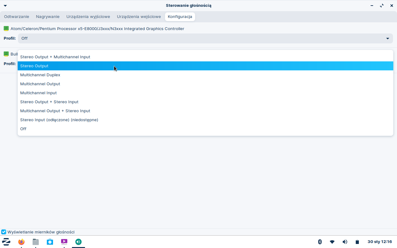

On pulseaudio in config tab I have no profile "Analog stereo duplex" I tried to switch to each one in the list , no results

What options do you see in the dropdown menu for first Profile?
Have you tried turning that Profile on and see the effect of doing that?
@zabadabadoo yes i tried. It seems that this profile is for HDMI, which is currently not connected
words in brackets are disconnected / unavaliable
Ah OK. Worth a look, but no help.
True, bad news is that I am going to give up (slowly)
